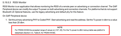

I am testing ble functions  with KW38 EVB; using sample project of [BLE shell].
Test command is "gap txpower [adv/conn] [powerLevel]"
According to source code, powerLevel should be -127 ~ 127.
but the value of powerLevel between 30~127, always (FAIL)
Anybody tell me the specific condition(or reason) of FAIL?
PowerLevel -127~20 : Success
PowerLevel 30~127 : FAIL             <------------- This point.
PowerLevel under -127 : Error
PowerLevel over 127 : Error

I reproduced the problem you mentioned on my side. On the frdm-kw38 board, this is expected. We can consult the section 5.19.5.3 RSSI Monitor in the Bluetooth Low Energy Demo Applications User's Guide.  It is explained as follows:

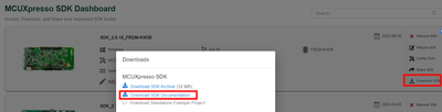

You can get this documentation and other guides provided by NXP here: After building the KW38 SDK, please download the SDK documentation.
And the location of this guide is here for you to view: SDK_doc_Root_Path\docs\wireless\Bluetooth\Bluetooth Low Energy Demo Applications User's Guide.pdf.

Thanks , Pretty reasonable.
