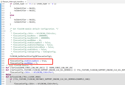

I am using sample project "frdmkw38_flexcan_interrupt_transfer" to try CAN-FD.
If I want to send 64 bytes data through, I set "DLC" as 15.
In loopback mode, I send 64 bytes data, but I only receive 16 bytes.
Is there any configuration I miss?
Thanks.

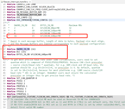

Hi, @Adam_Ho
#define RX_MESSAGE_BUFFER_NUM (6)
#define TX_MESSAGE_BUFFER_NUM (5)
If use kFLEXCAN_64BperMB, the Maximum MBs is 7.
So the "RX_MESSAGE_BUFFER_NUM" and "TX_MESSAGE_BUFFER_NUM"  should less than 7. Pleas set "RX_MESSAGE_BUFFER_NUM" to 6, and "TX_MESSAGE_BUFFER_NUM" to 5, then the system would work normally.
I tested it on my side, it is ok. Please try it on your side and let me know your results.

Christine_Li
Hi, @Adam_Ho
Thanks for creating case to us and hope you are doing well.
I checked our SDK code, and may I ask whether you only modified DLC from 10 to 15 or also changed DWORD_IN_MB and BYTES_IN_MB?
For your information:
Dword in each message buffer, Length of data in bytes, Payload size must align,
and the Message Buffers are limited corresponding to each payload configuration.
So please also modified DWORD_IN_MB and BYTES_IN_MB to the one related to DLC to have a try.
Christine.

I think it should be matched with below:
 *    DWORD_IN_MB    DLC    BYTES_IN_MB             Maximum MBs
 *    2              8      kFLEXCAN_8BperMB        32
 *    4              10     kFLEXCAN_16BperMB       21
 *    8              13     kFLEXCAN_32BperMB       12
 *    16             15     kFLEXCAN_64BperMB       7

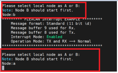

Just to confirm with you, after you change all parameters related to 64Bytes, then the board doesn't have any response, am I right?
I am trying to reproduce your issue, and above is what I saw on my two boards(one as TX, one as RX).
But when I changed back to 32Bytes related parameters, it can work properly.
Error phenomenon is like below:
Is is same as your side?
Christine.

Adam_Ho
Hi @Christine_Li ,
Yes, you reproduce  my issue.
I think Rx buffer size is wrong, so system in 64Bytes parameter when rx data  coming system go to wrong address.
Then system halt.
