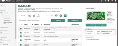

ovidiu_usturoi
Hi @Nidhin ,
Please note that the MCUXpresso SDK 2.6.10 for KW37 Maintenance release 3 (MR3)  has been successfully deployed on the https://mcuxpresso.nxp.com.
The fix for your reported issue has been integrated.
Ovidiu
