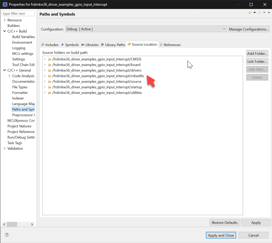

The current nxp sdk of kw36 does not support RSA 1024 encryption/decryption algorithm.
Will nxp be able to add RSA-1024 code in our framework in the nxp sdk we have?

Hello Sai Kalyana,

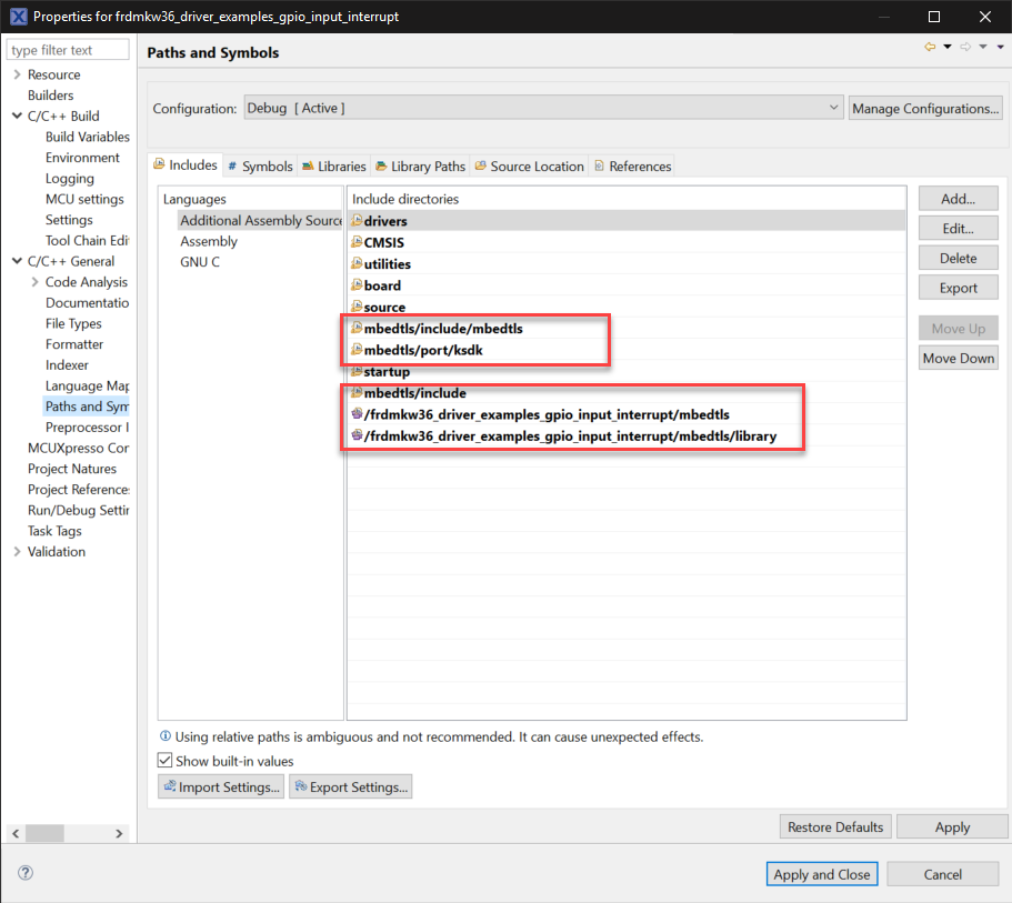

As you mention de current stack doesn't support the RSA encryption so I will suggest to use the mbedLTS library for this.
In the SDK from the FRDM-KW41 this library is already integrated so could check the example frdmkw41z_demo_apps_mbedtls_mbedtls_benchmark, copy the folder mbedtls and update the paths of your project.
I hope this helps you.
