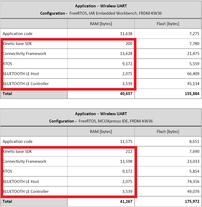

Sebastian_Del_Rio
Hi Naven, I hope you're doing well!
The minimum requirements to run the UART profile for the KW36Z can be found in the KW36's Bluetooth Low Energy Release Notes (included in the SDK documentation folder, on the following path: <\SDK_2.2.0_FRDM-KW36\docs\wireless\Bluetooth>).
The requirements are located in the following tables, depending on which IDE you'll develop with:
The cells surrounded by the red square represent the minimum memory (RAM) requirements for each of the components, the rest is free for application development.
Note: These calculations exclude application code, as that may change depending on development.
Please let me know if you have any further questions.
