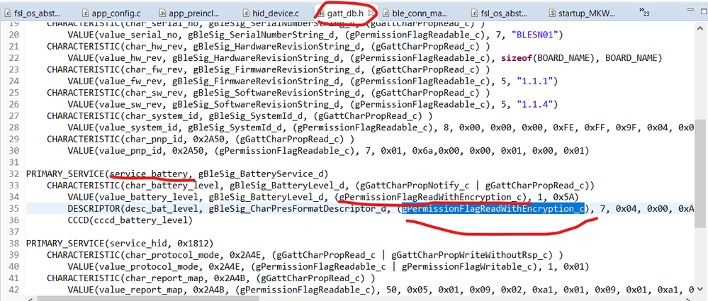

the problem is: while the Pairing and bonding are succeed, but if set the Char & Char value ACCESS level to gPermissionFlagReadWithEncryption_c or gPermissionFlagWriteWithEncryption_c , the mobile app cannot read or write successfully from/to these values.
my working environment:
IDE: MCUXpresso

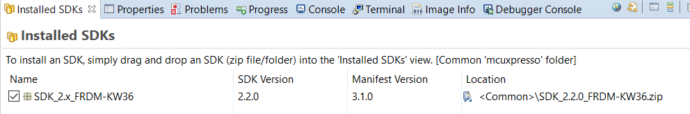

SDK:
Demo project:
frdmkw36_wireless_examples_bluetooth_hid_device_freertos
code changes:

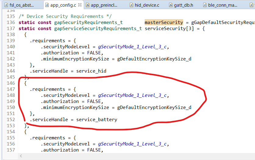

changed the security level to gPermissionFlagReadWithEncryption_c , should be security mode 1 level 2
others are never changed, the default security mode setting in project is mode 1 level 3. this should not be the problem.
the problem :

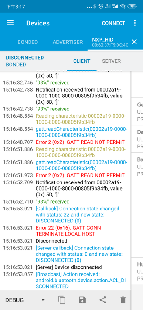

the NRF connect or lightblue can successfully Pairing and bond with the device, but cannot READ the value_battery_level. the error code is GATT READ NOT PERMIT
the original source code set the permission to lowest level, will not have this issue, please check this issue.
Thanks.

zhi_wang
Hi Mario,
Glad to hearing from you.
i just take the battery service for an example. actually i have defined my private services.
i need the Pairing and bonding process, and the Characteristic value and description (0x2902 & 0x2901) are must encrypted.
from my testing, the pair and bond process are working as expected. if not bonded, the pin will request.
the issue happened only if i changed the ACCESS level of battery service.
from the log, the "gConnEvtEncryptionChanged_c" will be called and is successful.
it seems the Pairing , bonding and encryption are all ok. but the mobile app are not permitted to ACCESS the description and value.
you can take the HID Device as i did and have a try, the only changes from code is as i depicted above.
