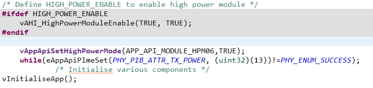

Is it possible to enable high power modules normally by adding only two functions to the main function?
vAppApiSetHighPowerMode(APP_API_MODULE_HPM06,TRUE);
while(eAppApiPlmeSet(PHY_PIB_ATTR_TX_POWER, (uint32)(13))!=PHY_ENUM_SUCCESS);

Hi, I hope you're doing well!
To enable High Power mode on the M05 and M06 modules, you'll need to use the following function:
vAppApiSetHighPowerMode.
You can see some examples and explanations on how to use this function in the attached document.
Please let me know if you need more information.
