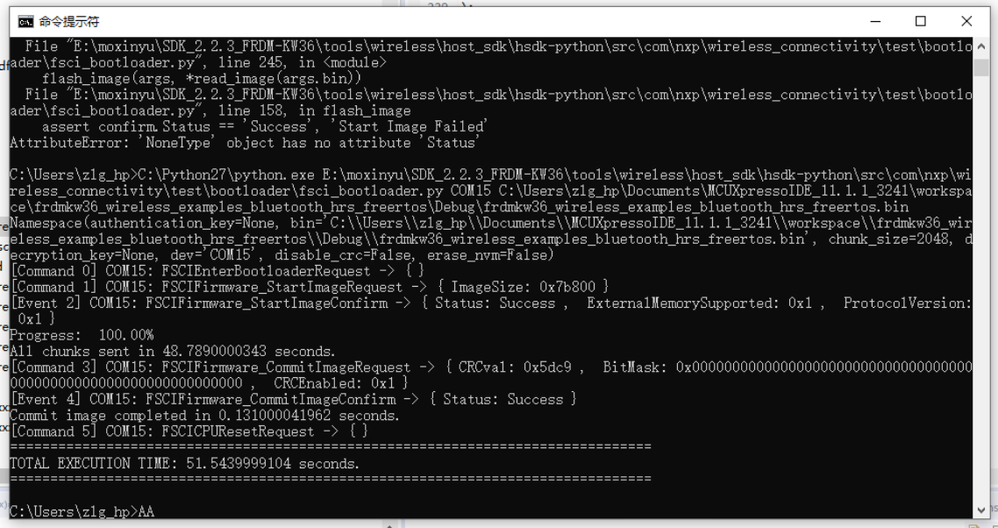

I want to use FSCI bootloader to update KW36 and I flow this: Reprogramming a KW36 device using the FSCI bootloader . It look like success:
But I press the sw, it does not start advertising. Does it fail to jump to appilcation? What should I do?

Was the application offset applied accordingly to leave space for the FSCI bootloader?
If the necessary space is not left for the bootloader, and the application is programmed to the board without it, it can cause the app initialization to fail, as the program's starting address is not where it was expected to be.
Could you please confirm?

To configure the necessary offset for the bootloader, the --defsym=gUseBootloaderLink_d=1 has to be added to the Linker settings in your project.
After adding this to the Linker settings, cleaning, and building the project again, the binary file should be generated, and then loaded as the guide you followed describes.
