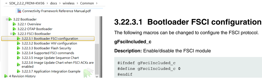

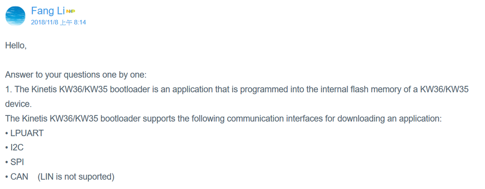

I found the link below and mentioned that the bootloader supports the CAN interface
https://community.nxp.com/thread/488445
 Only the following information was found from the SDK
Question:
1. I can't find detail files about  FSCI Bootloader in the SDK. What files can I refer to for the FSCI bootloader ?
2. How to change FSCI bootlaoder from UART to CAN?

stephanie_m
The MCUBOOT is already implemented with CAN, so it is ready to use , still, if you want one with FSCI there is no such example and you will need to implement it by yourself using the available source files as a base for your implementation.
Please, check this document, those are the different bootloader available in the KW family, you will need to check which one of those is the one that you and your customer need.

stephanie_m
You can find the project in the following path:
<installation path>\boards\frdmkw36\wireless_examples\framework
It is located in the framework examples  of the SDK.
Still, you are combining two different bootloaders, the ones you are referring to is the Flashloader and the other is a bootloader based in FSCI commands, you will need to check which ones is the one you are looking for that cover your needs.
