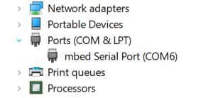

How is your device manager showing the KW01?
Did you try to program the KW01 with IAR? Did you change the debugger option when you try to download?
Mario
5,937 Views
tedwu1
Hi Mario,
My device manager is showing as follows:
I program my code to MKW01Z128 with IAR. But, I don't program any code to MK20DX128VFM5. (OpenSDA interface)
Ted

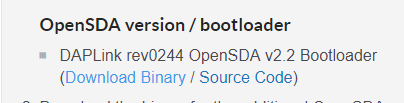

I still can't find bin file of FRDM-KW019032 to upgrade my board. I don't know which bin file is compatible to use. I can download the bin file from USB.
Ted
5,937 Views
mario_castaneda
Hi Ted,
Could you please update the OpenSDA bootloader?
The download binary is not available for the KW01, but you could use the OpenSDA v2.2 bootloader that is available in the K64 MCU.
Note: Please follow the link that I provided in the previous comment.
Mario
5,937 Views
tedwu1
Hi Mario,
I followed your guides. I downloaded the latest DAPLink software and the version is 254. Using KEIL to build the project of k20dx_frdmk64f_if and I got 4 bin files. They are  k20dx_frdmk64f_if.bin,  k20dx_frdmk64f_if_crc.bin,  k20dx_frdmk64f_if_crc_legacy_0x5000.bin  and k20dx_frdmk64f_if_crc_legacy_0x8000.bin.  I downloaded k20dx_frdmk64f_if.bin to openSDA interface through USB. The issue is fixed. Thank you very much.
