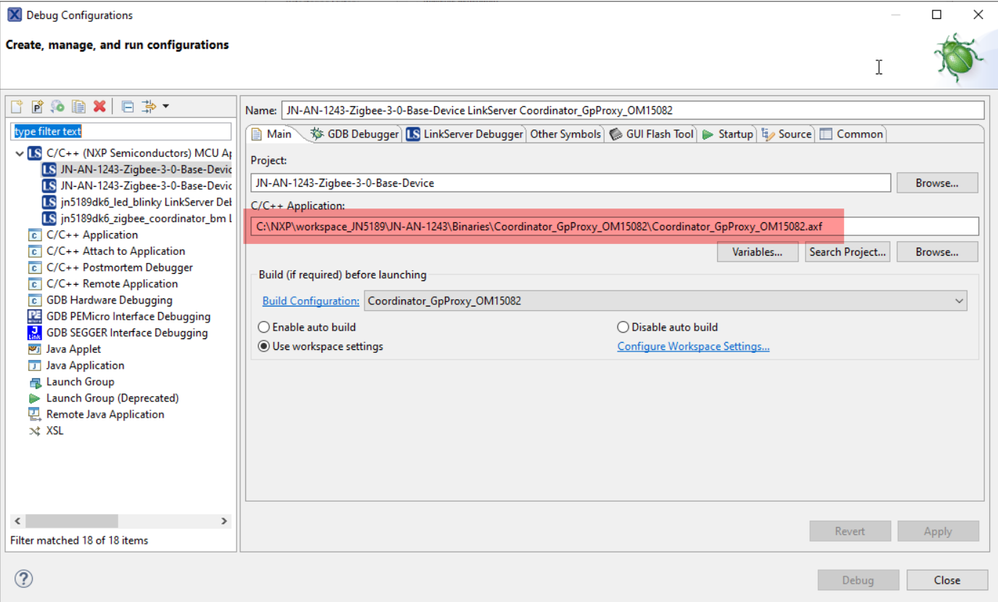

There are some issues with installing the JN5189 routines,My SDK does not match when importing the project, but I installed the 1260 documentation operation.Failed to compile.DRA}F@A(_$KL4DZXP5(UJ0Y.pngXOU03[4H3ZWB77QQK(SPDND.png

Hi Linklai, I hope you're doing well!
Could you please try the following procedure to ensure that the Application Notes compile successfully?:
First, the Application Note's Makefile needs to be changed for the corresponding chip:
# Set specific chip     (choose one)
#JENNIC_CHIP           ?= K32W061
#JENNIC_CHIP           ?= K32W041
JENNIC_CHIP           ?= JN5189
#JENNIC_CHIP           ?= JN5188
And the toolchain path needs to be changed to your corresponding MCUXpresso Version:
# Toolchain paths
TOOLCHAIN_DIR_PATH  = ../../../../../MCUXpressoIDE_11.2.0_4120/ide/tools
TOOLCHAIN_PATH      = $(TOOLCHAIN_DIR_PATH)/bin
The MCU Settings must be configured to use the JN5189 driver:
In the project's settings, please add the following build command to the options:
DEBUG=HW
Like so:
And finally, the compiled .axf file needs to be selected in the debug configuration:
Note: Be sure that the JP4 and JP7 are shorted as 3-4 on the board.
Please let me know if you need any more information or have any further issues.
Sebastian
