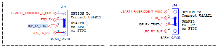

K32W board needs to use FTDI_USB or USB_UART to execute Flash Prrogrammer.
But usually Uart of SOC is directly connected to PIO8/PIO9(TX/RX) of K32W, and there is no FTDI_USB/USB_UART
How does SOC do Flash Programmer?

mario_castaneda
Hi Daniel,
I hope you are doing great.

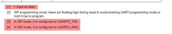

Our EVB provides 2 different ways to program the JN5169, using the LPC or the FTDI. You could select depending on the jumper set up of the JP7 and JP4.
In this case, the ISP_TX_TRGT and ISP_RX_TRGT are connected to the PIO8/PIO9(TX/RX).
For a better reference, you could look at the K32W Datasheet.
Mario
