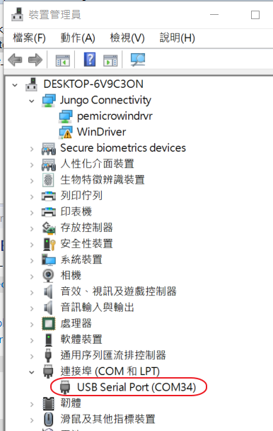

I use "LPC-Link2" for debugging can work, but it doesn’t work when I use "FTDI".
FTDI : JP4&JP7 short 2 and 3.
PC's USB connection Carrier Main Board show following:

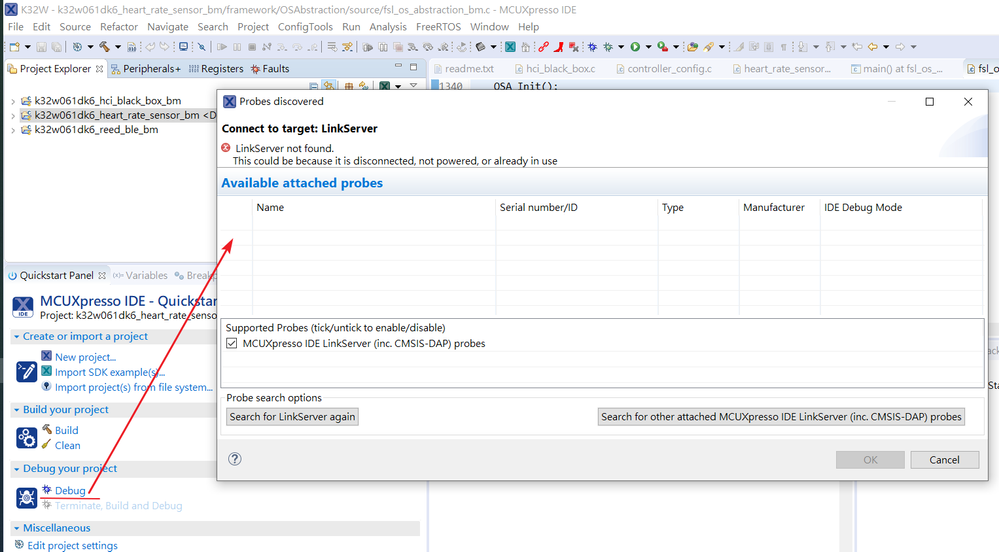

Use MCUXpresso IDE to download, it will not download

mario_castaneda
Hi Daniel,
The FTDI is not for debugging purposes.
We provide a tool, DK Production Flash Programmer can be used to program the binary files into the DK006 boards. The installation of this tool is described in DK6 Production Flash Programmer Installation.
This tool provides a faster program process without an external debugger, it uses a serial interface.
