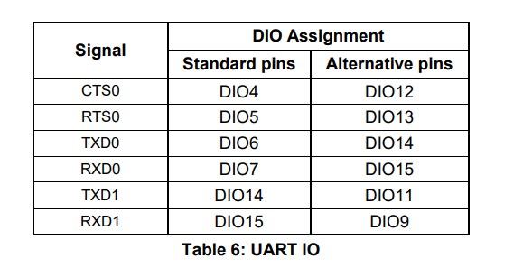

If you check the datasheet (Table 6) of the module and the JN516x you will be able to see that there is an alternative pin of RXD1 which  it's the DIO15 not only the one you mention of the crystal and it is mentioned as the JTAG one.

When the Beyond Debug Key (BDK) needs to put the JN5168 into JTAG mode, will the BDK drive Pin-17 on the BDK connector High or Low?
 For JTAG mode it needs to be high.
3)      When the BDK is not driving Pin-17 to enter JTAG mode, will Pin-17 still be driven or will it be in a high impedance state?
JTAG programming mode: must be left floating high during reset to avoid entering JTAG programming mode.
UART programming mode: leave pin floating high during reset to avoid entering UART programming mode or hold it low to program
