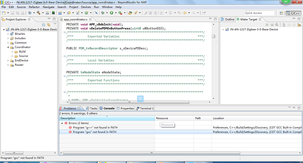

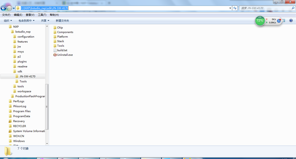

There always having errors "program gcc not found in the path" in the program views, I try some methods like setting the system variables and beyongstudio varibales, but these errors is existing. what should I dou ? Please neglect the bad English. thanks

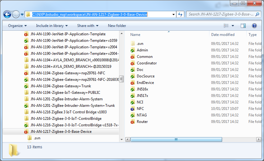

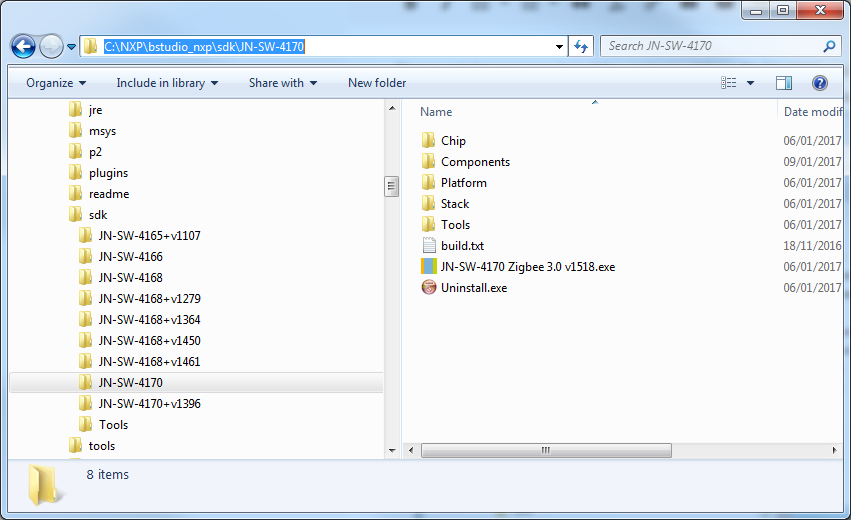

Hi Lei Yang,
Could you please share the screenshot of the contents of the JN-AN-1217 and JN-SW-4170 folders as I've shown below, ensuring that they have clicked in the address bar at the top of Windows Explorer so I can see the path on their computer:
Mario

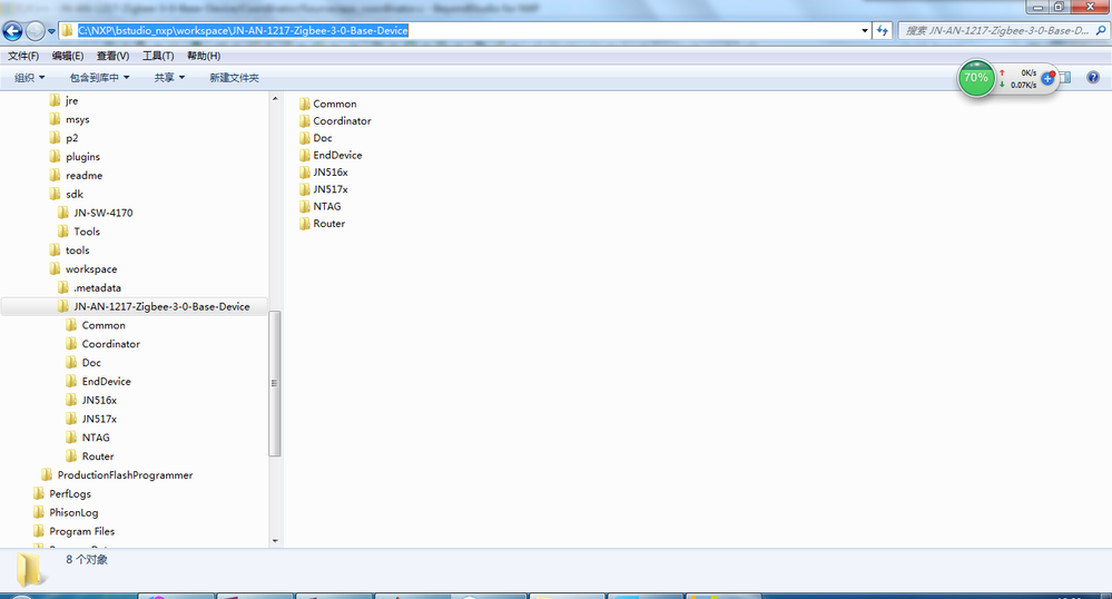

leiyang
Hi, Mario,
The problem has been solved. I reinstalled the beyondstuido again and just add the 'chip','common','components' and 'stack' folders to the project from 'JN-SW-4170' folder. Then building was successful. But I don't sure whether it was an approprate way to solve the problem. The screenshot in my computer as follows:
Finally, thank for your reply!
Lei Yang
4,748 Views
mario_castaneda
Hi Lei Yang,
The expected way is to:
1. Install JN-SW-4141 which installs mainly the IDE
2. Install JN-SW-4170 which should install into the C:/NXP/bstudio_nxp/sdk/JN-SW-4170, this should include the Chip, Components etc folders.
If files have been manually copied we can't be confident in what you are running to provide appropriate assistance.
Mario

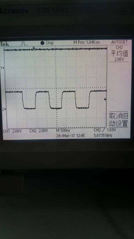

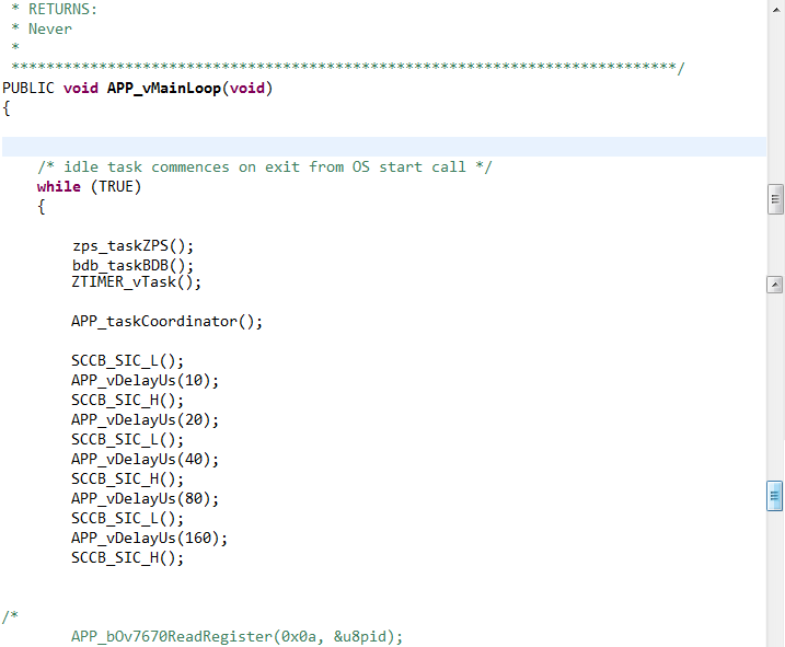

   I met some difficulties in JN5168 again. Now, I am simulating an IIC sequence through IO, but the delay function that I write was not work. The code is showed in figure 1. Can you give me some idea about this?
 In the code, I just want to detect the delay time of function. However, the pulse interval is same, is about 600ns.
Best Regards
Lei
4,748 Views
mario_castaneda
Hi Lei Yang,
Please check the Clock configuration, bool_t bAHI_GetClkSource(void); You should know what is the frecuency that your application is running.
The time delay is very low and you can't see that different.
Mario

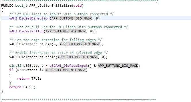

I encoutner another problem. In my project, I need use more DIO and I found I can not control some DIO, like DIO4, DIO5, DIO6, DIO7, DIO18, DIO19, DIO20. These PINs keep fixed level, whether I change their status.
See relevant manual, I found these PINs were designed to other functions, as DIO4, DIO5, DIO6 adn DIO7 were about JTAG.
How I can disable the JTAG function and control relevant PINs?
Best Regards
Lei
4,748 Views
mario_castaneda
Hi Lei Yang,
As you can see, the JN-AN-1189 has a buttonInitialise function.
When a peripheral is enabled, it takes control over the device pins allocated to it.
Hope it helps.
Mario
