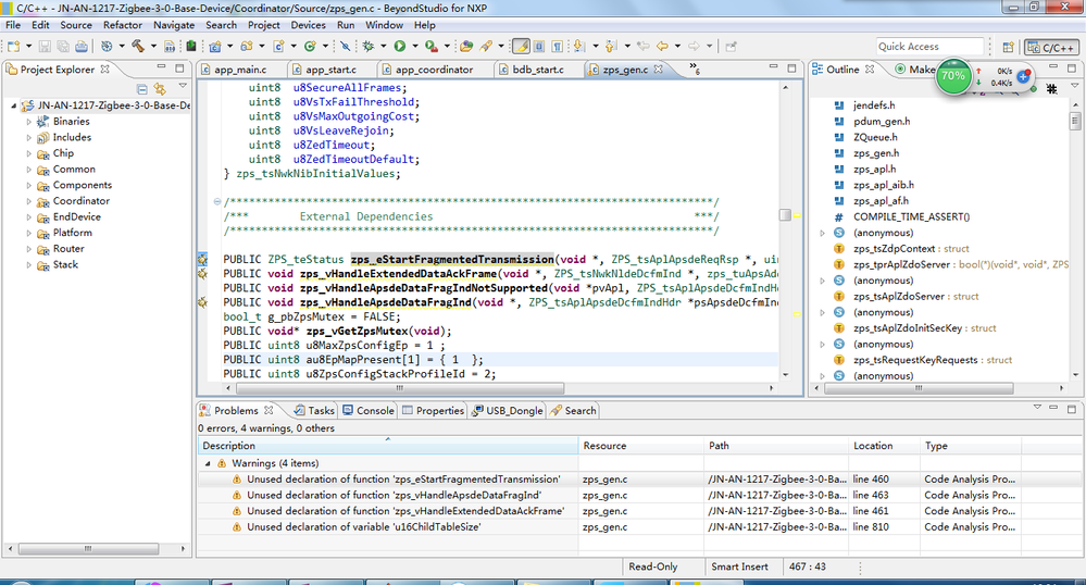

There always having errors "program gcc not found in the path" in the program views, I try some methods like setting the system variables and beyongstudio varibales, but these errors is existing. what should I dou ? Please neglect the bad English. thanks

Hi Lei Yang,
Could you please share the screenshot of the contents of the JN-AN-1217 and JN-SW-4170 folders as I've shown below, ensuring that they have clicked in the address bar at the top of Windows Explorer so I can see the path on their computer:

Hi, Mario,
The problem has been solved. I reinstalled the beyondstuido again and just add the 'chip','common','components' and 'stack' folders to the project from 'JN-SW-4170' folder. Then building was successful. But I don't sure whether it was an approprate way to solve the problem. The screenshot in my computer as follows:
Finally, thank for your reply!

Hi Lei Yang,
The expected way is to:
1. Install JN-SW-4141 which installs mainly the IDE
2. Install JN-SW-4170 which should install into the C:/NXP/bstudio_nxp/sdk/JN-SW-4170, this should include the Chip, Components etc folders.
If files have been manually copied we can't be confident in what you are running to provide appropriate assistance.
