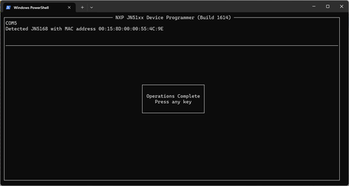

luis_maravilla
Hi Francisco
Could you help us running this command on Flash programming tool to see what the MAC Address response is:
JN51xxProgrammer.exe -s COMxx [Enter the COM value for the JN Module]
You should see a MAC Address in the terminal like the following example:
[If you need help using the FlashProgramming refer to JN51xx Production Flash Programmer User Guide]
Additional to this test, could you provide your sniffer loggers for your application results please.
Best Regards
Luis

ffonck
Hi Luis!
I ran the command u sent me, the following image has the output prompted:
The sniffer you are talking about is another device or you're referring to just the output messages?
Regards, Francisco
