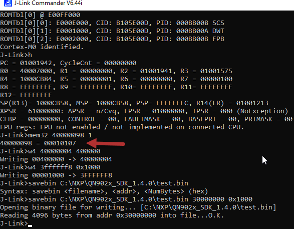

        Is there an alternative location QN9020 look for NVDS data apart from 0x30000000? I have verified using JLink I can read the NVDS data from the QN9020  MiniDK board from location 0x30000000. But when I do it from the internal board it, returns all 0 for at least about 0x1000 locations. But if I read the data using NVDS configurator the tool can read the value. So the system does have access to the nvds data. But not clear where is it reading from!

Hi Tony,
What is the value of the register that you readout? 40000098
Power on flash: see register 40000098 value, mem32 40000098 1
if bit 2 is to 0, set bit 2 to 1, saving the previous values of the register.
Mario

tonymakkiel
Attached [data.bin] is the bin file read using JLink and the commands used were
mem32 40000098 1
w4 40000004 400000
w4 3ffffff8 0x1000
savebin C:\Users\tony.makkiel\Desktop\data.bin 0x30000000 0x1000

mario_castaneda
Hi Tony,
Mario
6,537 Views
tonymakkiel
Thank you very much Mario. That bit was not set. Now I can read the data there.
