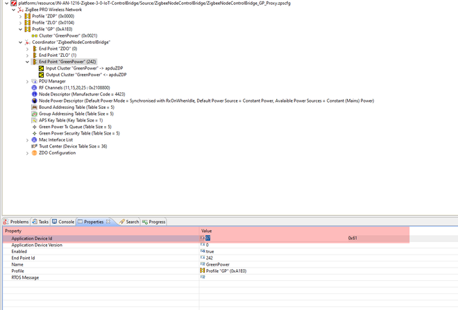

mario_castaneda
Hi @sChameleoNz,
Please look at the JN-AN-1247 Control Bridge.
You could find the app_green_power.c/h files that provide the supports for the Proxy support.
You have to enable the GP_Support in the Makefile and be sure that the file is selecting the .zpscfg
Mario

sChameleoNz
Hi @mario_castaneda,
Thank you for your guidance.
I selected like below.
GP_SUPPORT			   ?= 1

mario_castaneda
Hi @sChameleoNz,
Please clean the example that you want and build it again.
The device ID is set in the endpoint 242 to 0x0061.
