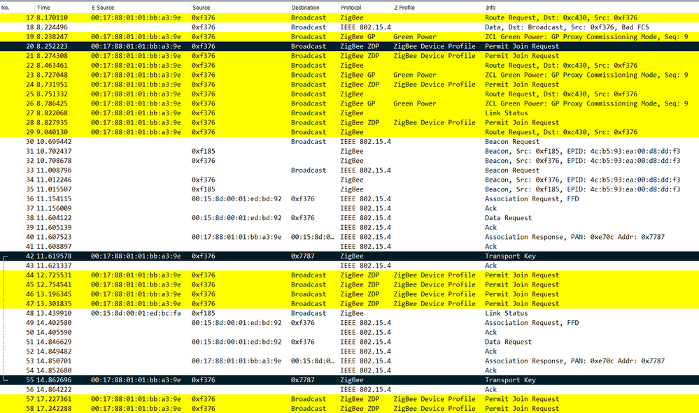

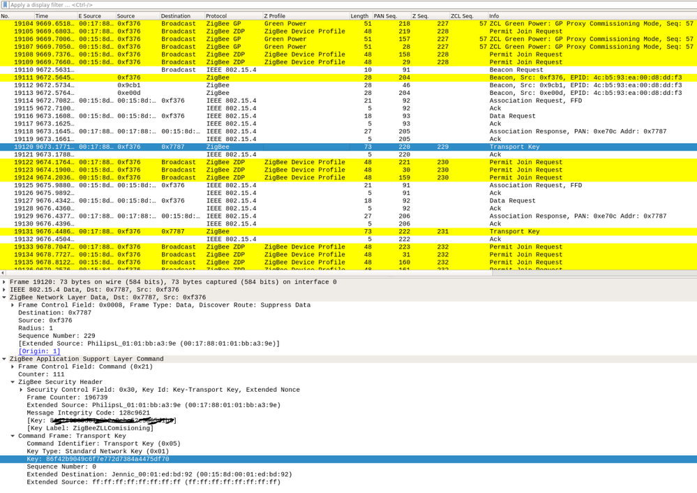

In the trace I see the "Permit Join Request" and the "Beacon Request", I also see the transmission of the "Transport Key". It seems that my JN5168 does not want to respond to that "Transport Key" transmission due to "FailedToJoin sNwkJoinFailedEvent.u8Status=173 !!!".
I am using ch 11 exclusively on all network nodes.
I hope you can open Google Drive Links. I also added a trace of different lamp with a JN5169 chip (Not my SW) inside for which pairing works.
pairing_jn5169_paulmann_successfull.pcapng
pairing_jn5168_own_failed.pcapng
Based on the traces in Wireshark I can see that the Zigbee Light Link Commissioning Key is used. Don't want to print it here, but you can find it on the web. For example here. *cough**

  1. I start the pairing on the Bridge
  2. Switch on the JN5168 Chip and it's immediately found by the Bridge
  3. Bridge starts sending the Transport key.
  4. Based on my trace with wireshark I know that it is encrypted with "81 ...TOUCHLINK_CERTIFICATION_LINK_KEY"
  5. JN5168 receives it, but throws error FailedToJoin sNwkJoinFailedEvent.u8Status=173 !!!.
So somehow I am missing the correct place in the code to add this "81 ...TOUCHLINK_CERTIFICATION_LINK_KEY" key.
With "JN-AN-1171-ZigBee-LightLink-Demo" and "JN-SW-4168" everything works fine after changing.
s_au8ZllLnkKeyArray[16] = { 81 ...TOUCHLINK_CERTIFICATION_LINK_KEY }
Any idea what I am missing?
