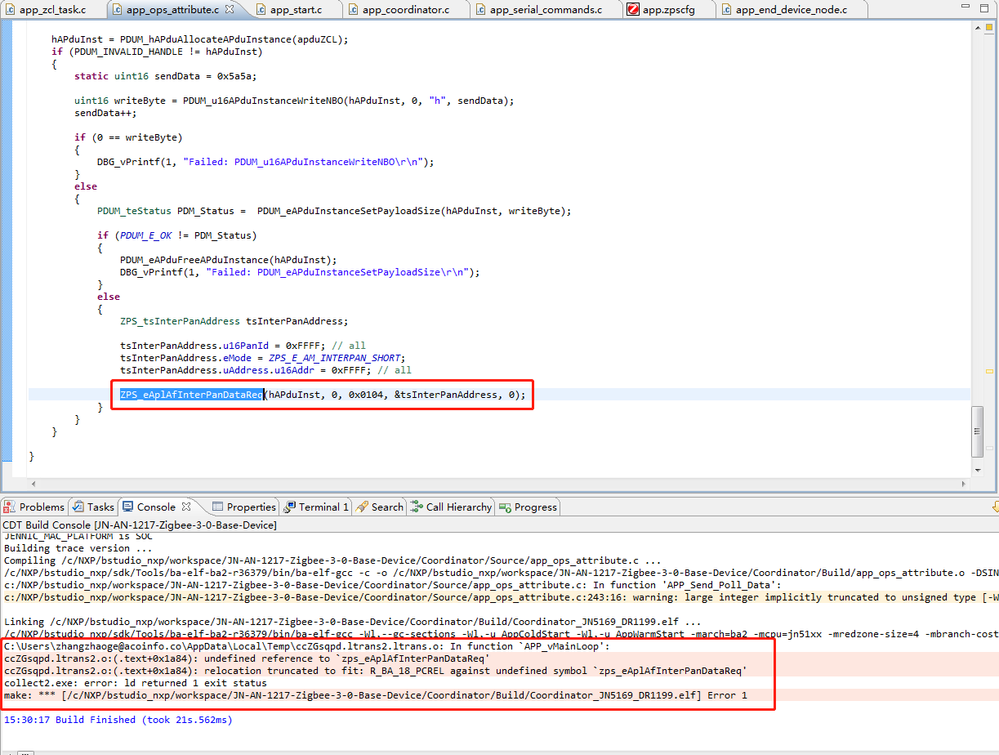

    In my project,i want use ZPS_eAplAfInterPanDataReq interface to send data from coordinate to end device.But
the prompt information is can't find the symbol at linking time.The details are as follows:
    In which library is this function implemented and how to add it to my project.

Hi Zhang,
You can refer to bulb application note which supports touchlink as it uses inter-pan JN-AN-1218
and also the stack user guide.
Mario
