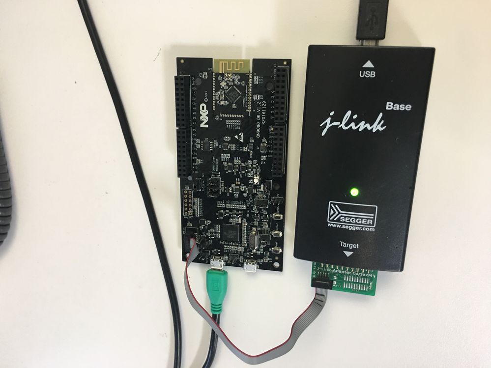

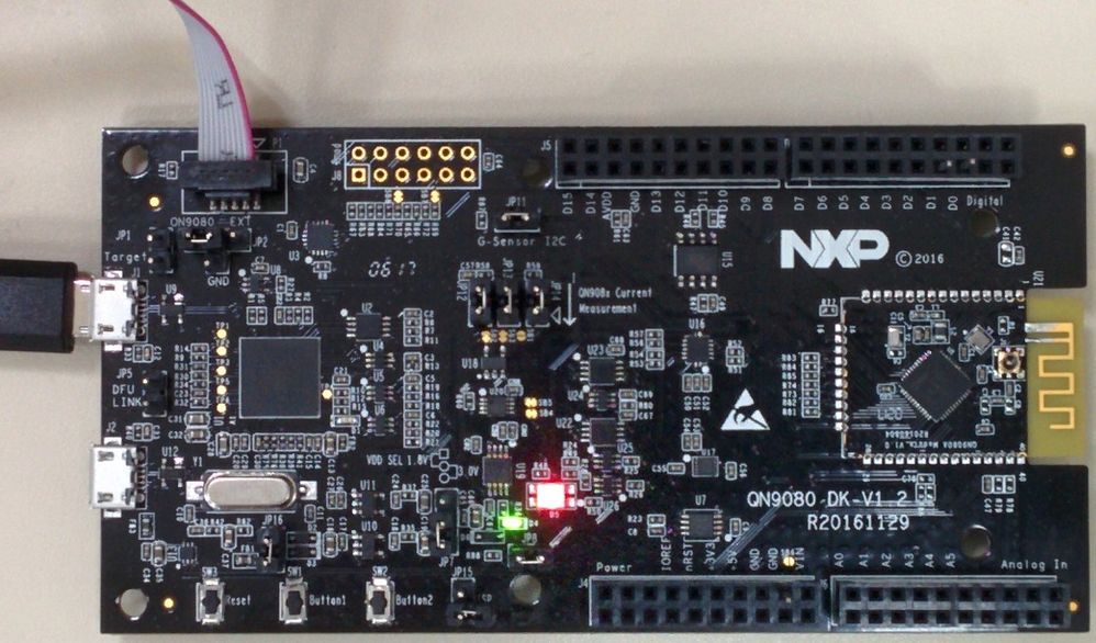

I was able to program the QN9080 with an external J-Link and powering the board through J1 with both MCUXpresso v10.0.2 and IAR 8.11. Here is a picture of my setup:
What is the version of your QN9080DK?
The QN_PA23_TMS_SWDIO signal from the QN9080 module is connected directly to P1 pin 2 (IF_TMS_SWDIO) and QN_PA22_TCK_SWDCLK signal from the QN9080 module is connected by U3 (double-throw analog switch) to P1 pin 4 (IF_TCK_SWCLK). Can you verify we have the same jumper connections from the picture above?
Regards.

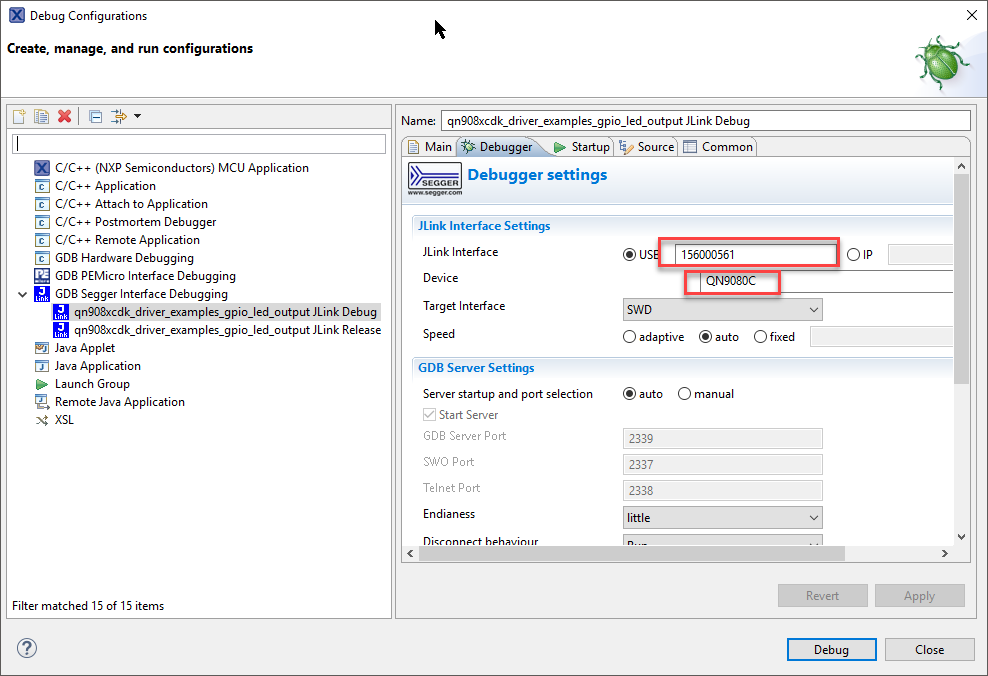

I'm also having problem with using Segger J-Link debug probe and MCUXpresso IDE to debug the QN908x DK board. I see the picture and thread you posted above, it looks like you were able to "program" the board successfully. Were you using the QN9080 Programmaning tool just to program it, or were you actually using MCUXpresso IDE to conduct a debug session via J-Link probe? If it is the latter, I'm very interested in learning how you set it up. I have all the jumper setting just like yours. I also connect the power to J1 and dubug probe to P1 (I had to remove pin 7 of the connector to fit the Segger J-Link probe). I followed the instruction in section 4.4 of the Quick Start User Guide:
https://www.nxp.com/docs/en/nxp/user-guides/UM11097.pdf
to change the debug mode to J-Link. I also get latest version of JLink driver.
Despite all that, it still fails on me.
The attached picture shows my hardware setup.

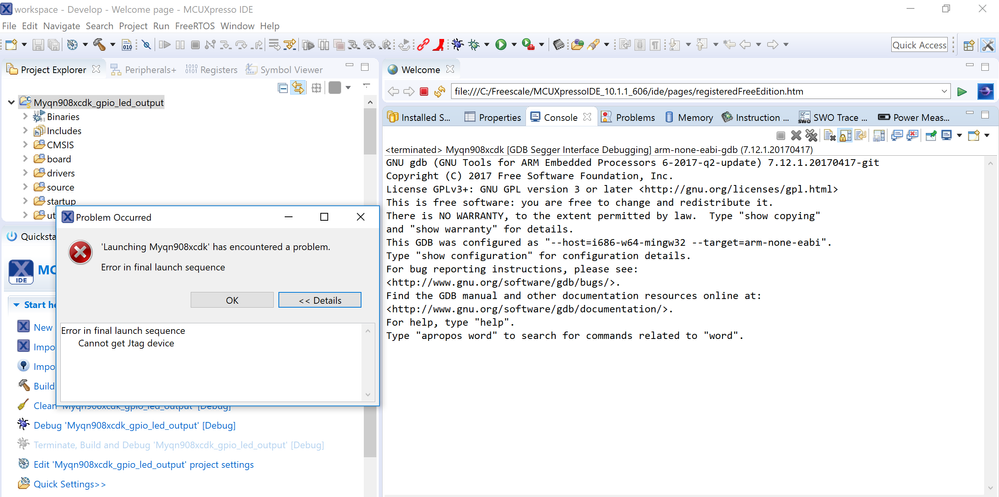

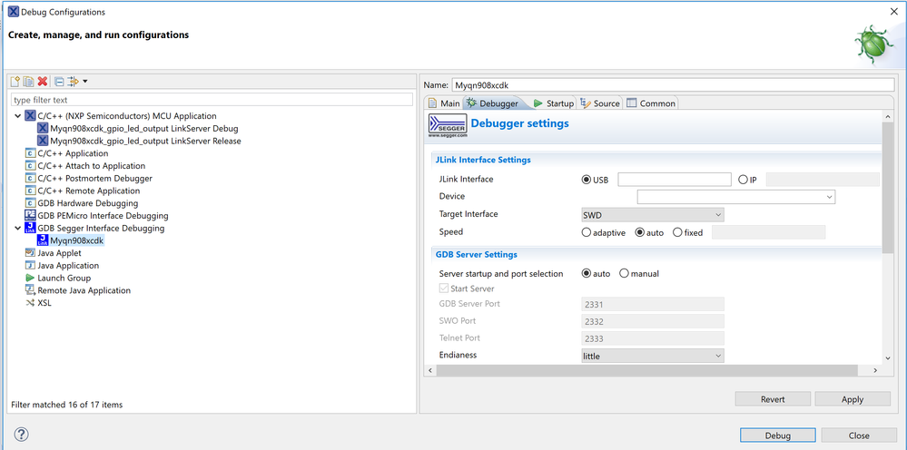

The following shows my Debug Config menu in MCUXpresso IDE:
The following shows the result:
Would appreciate your review and pointing out anything that I might have missed.

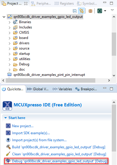

With this setup I could use MCUXpresso IDE to conduct a debug session via J-Link probe. I find strange in your debug Configuration window that the JLink interface and Device was not detected correctly. See below my window, where the JLink interface displays the S/N of my JLink probe and the Device is "QN9080C".
Did you create the debug configuration manually? If so, please delete this debug configuration and instead use the Debug "project_name" option from the Quickstart Panel
This button will start a debug probe discovery and create the debug configuration accordingly.
Let me know if this solves the issue.
Gerardo

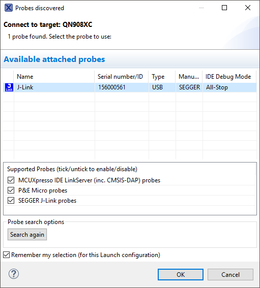

Hi Gerardo,
I think I made a mistake not to delete all configurations. I only deleted the one I manually created, leaving still the one in the "C/C++ (NXP Semiconductors MCU Application" menu. That's why I got the error message. Now after I deleted all configurations and started over by pressing "Debug <project name>" button, it can discover the J-link probe now.
With great pleasure, I'm informing that I solved my problem, mostly thanks to your advice in this post.

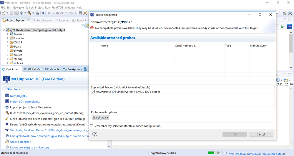

Yes, I did create it manually. I followed your advice and deleted it. Now I'm using the button "Debug_<project name>"  in the Quickstart panel. Unfortunately, I got no luck with the following response:
It couldn't detect the J-Link probe. What kind of probe are you using? I wonder I got the wrong probe (J-Link base) as in the above picture.

danieldelatorre
Thanks! My issue was with JP16, I didn't have a jumper there so it was expecting a batter!
