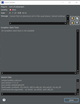

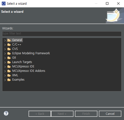

sChameleoNz
Hi @mario_castaneda,
After install the plug-in, I cannot run the MCUXpresso IDE.
Whenever I ran this program, it automatically shut down.
So, I reinstalled the program.
After that, I can see the error whenever I ran this program.
Moreover, I couldn't find the installed Zigbee Configuration Editor.
sChameleoNz_1-1627392390224.pngsChameleoNz_1-1627392390224.pngsChameleoNz_2-1627392419664.pngsChameleoNz_2-1627392419664.png
I need your help.

sChameleoNz
Finally, I found the method.
I could install using the menu Help > Install New Software.
The path was SDKPackages\SDK_2_6_3_JN5189DK6.zip\middleware\wireless\zigbee\tools\Eclipse_plugins\com.nxp.sdk.update_site\content.jar.
