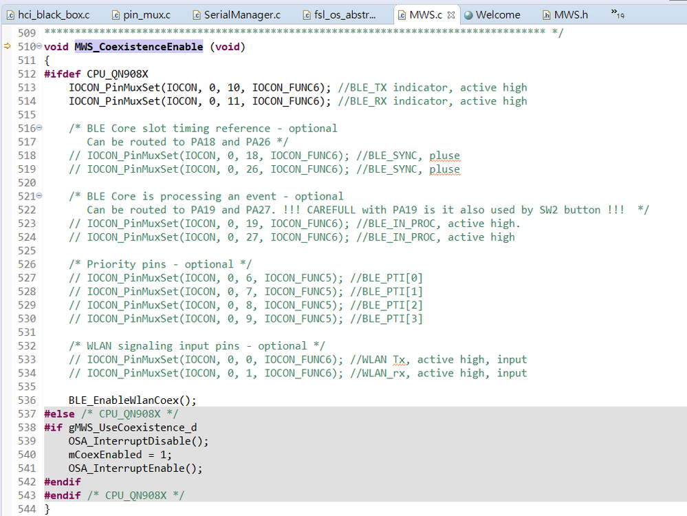

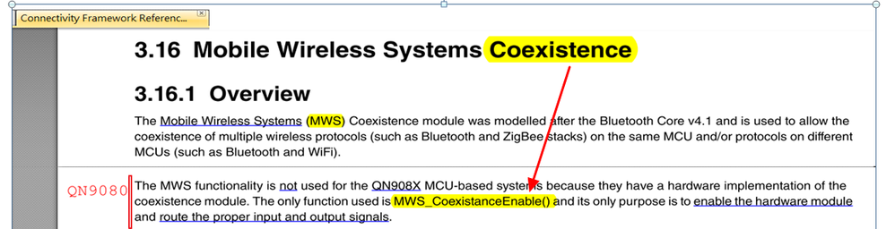

In the "connectivity Framework Reference" document, it is mentioned that MWS_CoexistenceEnable () can turn on the coexistence of QN9080.

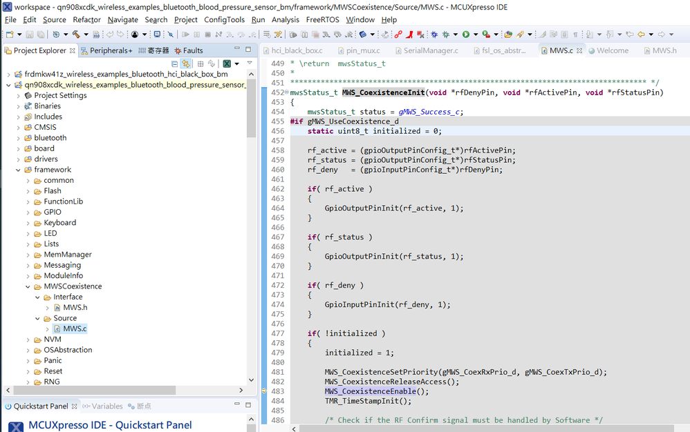

1。I need to enable gMWS_UseCoexistence_d ,but MWS_coexistenceInit() is not anyone called.
      How do I enable coexistence correctly?
2。In the program, are the pins not defined correctly?
