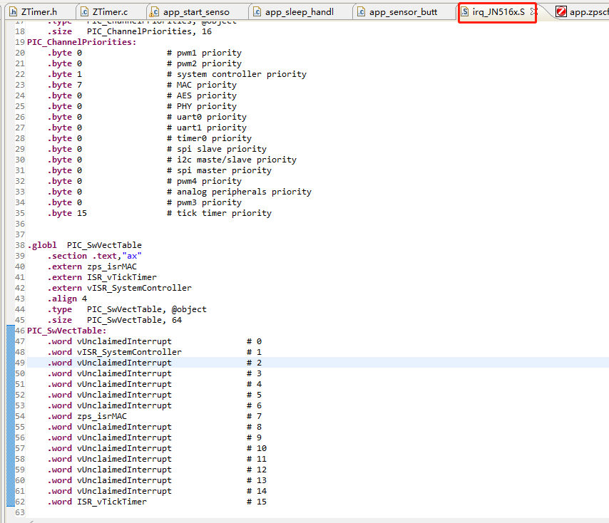

Environment:
  • JN5169
  • Base on JNAN-1220-Zigbee-3.0-Sensor
  • SDK:JN-SW-4170 Zigbee 3.0 v1840
Hi,I am making a single firewire switch,  a button controls a relay,And requires low power。
This device is a Sleep End Device. Every 0.5S wake up onece.
Sometimes an exception occurs,Exception appears in this function:ZTIMER_vSleep();
Debug log:
********** AppApiSaveMacSettings()
********** ZTIMER_vSleep()Unclaimed Interrupt at priority 0
u32PICMR = 0 : u32PICSR = 0
u32PICMSR = 0 : u32IPMR = 0
u32IHPR = 0 : u32AINT = 0 u32PINT 0
EPCR = a327f : EEAR = 71554daf
Stack dump:

How to deal with "unclaimed interrupt with priority 0"?
How to locate the problematic code based on the exception log?(use .map file ?)

mario_castaneda
Hi qingshu zhuang,
The ZTIMER_vSleep must be the last instruction before entering to sleep mode.
Please look at the JN-AN-1229 Sleep end device for a better reference.
PWRM_CALLBACK(PreSleep)
    vAHI_DioSetOutput(0,0x01);
    DBG_vPrintf(TRACE_APP, "APP: Going to sleep (CB)\n");
    vAppApiSaveMacSettings();
    ZTIMER_vSleep();
Mario

qingshuzhuang
There is irq_JN516x.s file, Not changed。
