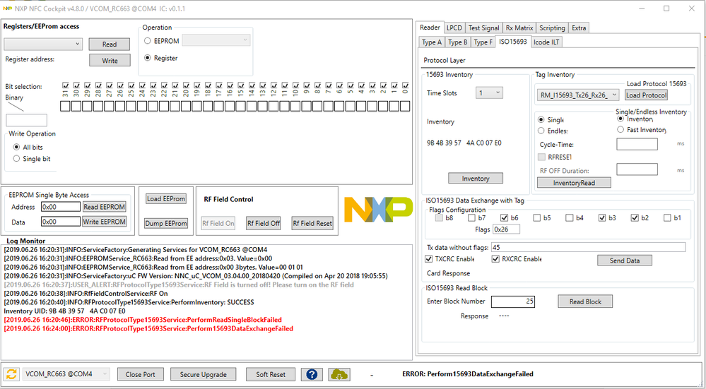

I'm using the NFC cockpit v4.8.0 to work with HF RFID tags using the ISO15693 protocol. I'm able to send data to a ISO14443A tag I have and receive bytes back, but when I try to use my ISO 15693 tag, I'm not able to write data to this card (ERROR:RFProtocolType15693Service:Perform15693DataExchangeFailed) or read blocks (ERROR:RFProtocolType15693Service:PerformReadSingleBlockFailed). I'm able to get the tag's UID through the Inventory button but reading and writing always throws these errors. Any advice would be great!
5,338 Views
IvanRuiz
According to the image, I assume you are working with CLRC663 eval board. Regarding the Tag, did you make sure that the Tag's block you are trying to read is not password protected or require authentication?
