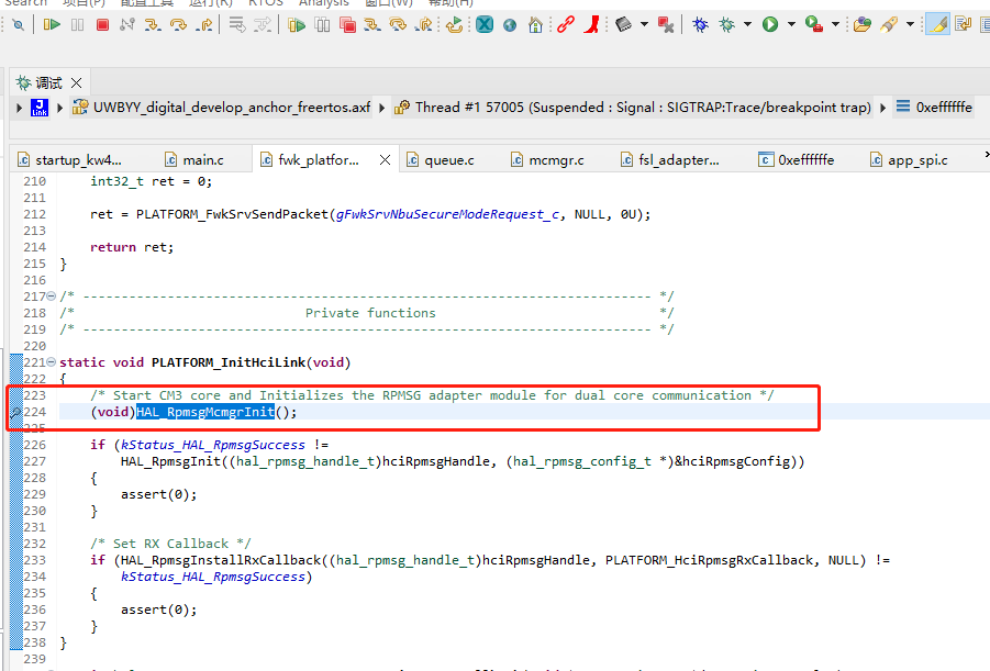

Hello!
      I have a new KW45 circuit board here, just started debugging. The program runs here, and the single step is out of control. What hardware is affected by this code?

I apologize for the late reply. After our internal discussion, this issue should be expected. Let me just confirm that the board works fine when not using step-by-step, right?
There are NBU and Cortex-M33 inside KW45, when we use IDE for single-step debugging, we only step-by-step debug the CM33 core. At the same time, NBU is always running at full speed.
This will cause problems with the synchronization between multiple cores. That is what you observed, the second core has not started. Therefore, it may be necessary to only add few breakpoints where necessary, and then run to the breakpoint, rather than complete single-step debugging. At the same time, in such a critical position, print may be required for necessary inspection.

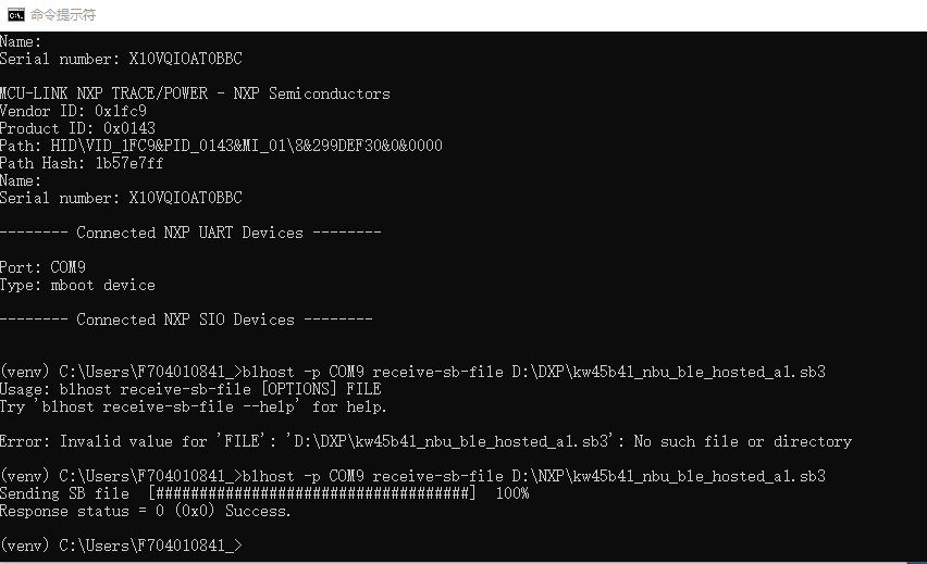

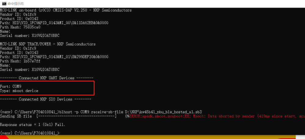

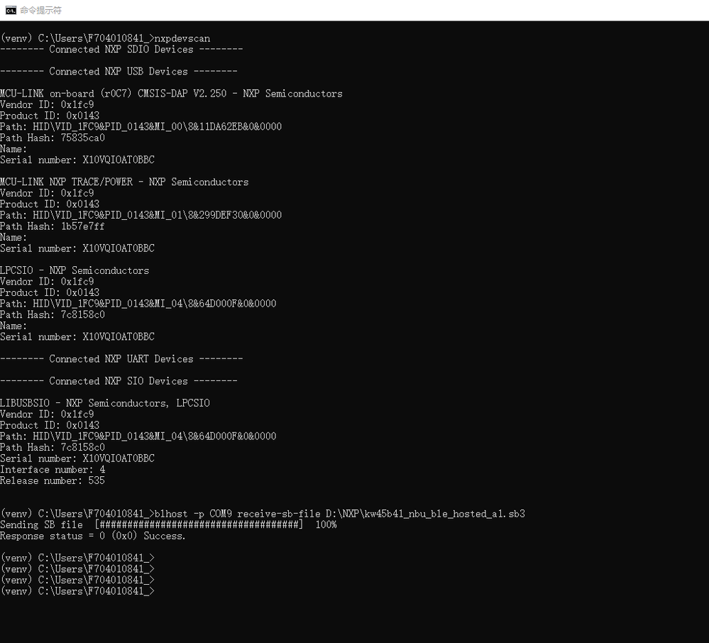

HI企业微信截图_16905267949410.png企业微信截图_16905267949410.png企业微信截图_16908777169118.png企业微信截图_16908777169118.png
Thank you for your approach.
I'll try the second method. In the first method, I used the micro USB port of the EVK circuit board to connect two external keys, RESET and BOOT_CFG.SPI, from the J12 port of the EVK circuit board to my own circuit board. At the same time, the RESET and BOOT_CFG of the EVK board are disabled, and the VBOARD voltage is up to 3.3V. This update recognizes the chip, but the download was unsuccessful.
I am considering whether it is possible to change the circuit on the EVK board to disable the SPI of the EVK board KW45, so as to connect to the SPI on my own board.The current situation is that the SPI of two chips (EVK board and own board) is connected together.

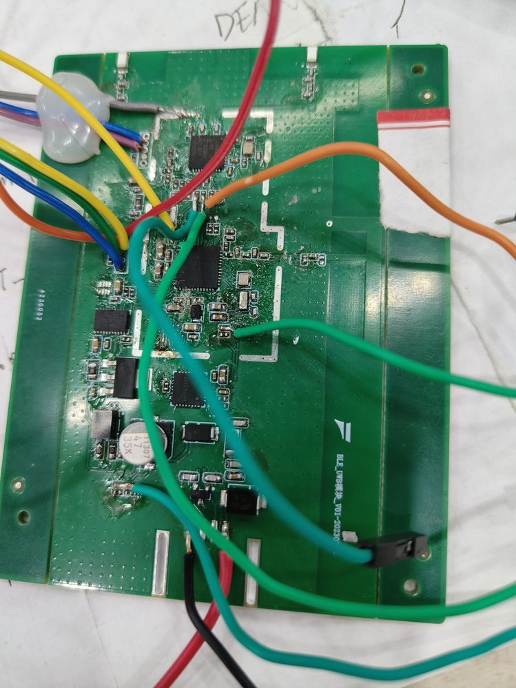

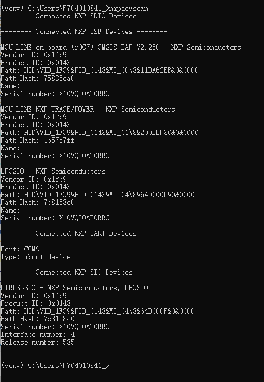

    I tried this upgrade, in the KW45B41Z-EVK this development board can make the NBU upgrade successfully. But I am using the board designed by myself to upgrade NBU, there is no microUSB port, there is no related reset case and BOOT_CFG button, please tell me how to upgrade NBU. I tried to connect the board to EVK J12 port for NBU upgrade, but it seems to have failed. Do I need to make some connections to the power supply of the EVK board to ensure the NBU upgrade of the external circuit board with J12 port? What am I supposed to do now?
   In addition, how do I determine my chip version? The silk screen of the chip has the words 2P43C, and I should upgrade the NBU of that version. Looking forward to your reply。EVK BoardEVK BoardHomemade circuit boardHomemade circuit board
企业微信截图_16903520385744.png企业微信截图_16903520385744.png企业微信截图_16903389689125.png企业微信截图_16903389689125.png

Taiyi
When the program runs here, it's out of control. What could possibly be the cause?
7,828 Views
Taiyi
This board is the first time to use, do you need to upgrade flash? Also, the status value of the variable in the picture has not changed, which may be caused by something?
