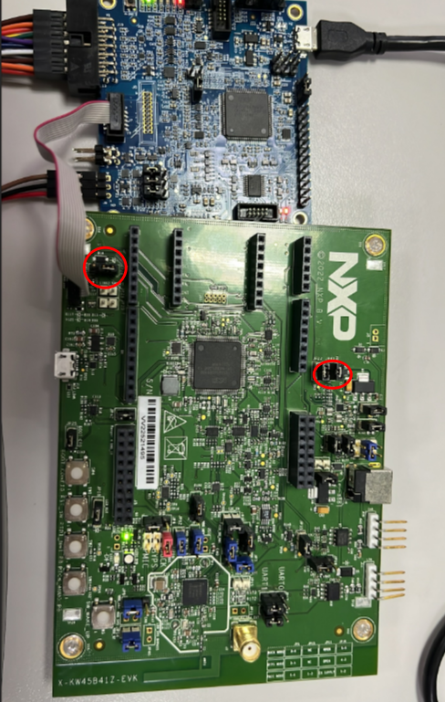

I am trying to flash the FW through the SWD interface of the KW45 EVK.
I saw that the EVK has two SWD interfaces, J16/J15.
When I connected MULTILINK to the J16/j15 SWD interface and tried to flash the FW via MCUxPresso TOOL, I got different errors.
I attached the full console message that occurs when flashing with each SWD interface, so please check it.
Is it not possible to flash SW on KW45 EVK using SWD interface?
Or is there something wrong with how to flash it?
Thanks.

Hi @sjshin ,
Hope you are doing well!

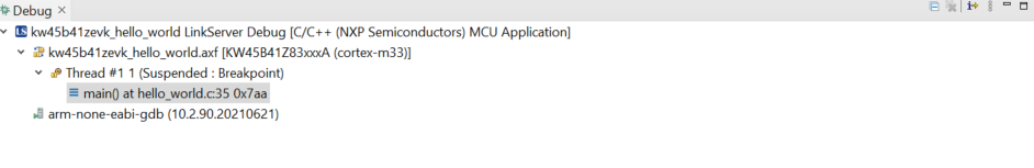

I tested on my side with demo project "Hello world" and successed.
Please refer to the KW45B41Z-EVK Board User Manual  Table 21 Supported debug scenarios. There are some differences between using internal debugger and external debugger. On my side, I used external debugger.
jumper configjumper config
attach debuggerattach debugger
resultresult
Hope it helps!
Gavin
