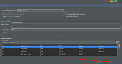

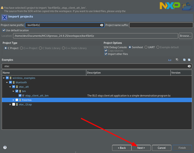

Installation allowed me to import examples and according to the application note I imported the otap_client_att_bm:
I finished the SDK Example import without changing anything:

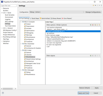

The application note then wants me to unset the `gEraseNVMLink_d` symbol, however, it is not part of the project:
Do I need the SDK in a different version? Can you give me a guidance on how to proceed in the application note?

one remark to this: I found the symbol `gUseNVMLink` in the project, should I set this to 0 (with `--defsym=gUseNVMLink_d=0`)?
Otherwise, if any other CM33 image is also fine, I could also continue with a simple hello world example to verify that this SWD flashing approach is working.

Hope you are doing well. Yes, the gEraseNVMLink_d linker symbol is on the MCUXpresso Project:
All of our BLE examples have this symbol.
Ricardo

The gUseNVMLink_d symbol is the correct one.
