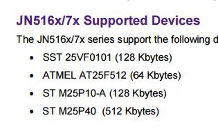

I am searching for a code example of an external flash memory.
BTW: Is it possible to use an flash memory which is not listed in  "JN51xx Boot Loader Operation"  document?

Hi Jurij,
You can find some SPI Sample codes following this path.
C:\NXP\bstudio_nxp\sdk\JN-SW-4170\Platform\DK4\Source\LcdDriver.c
C:\NXP\bstudio_nxp\sdk\*SDK NUMBER*\Platform\DK4\Source\LcdDriver.c
You can use another flash, but be sure that the flash support the SPI protocol and the voltages that de JN supports.
Mario

Ok found it, thank you
