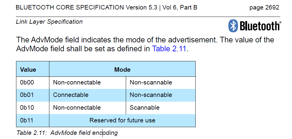

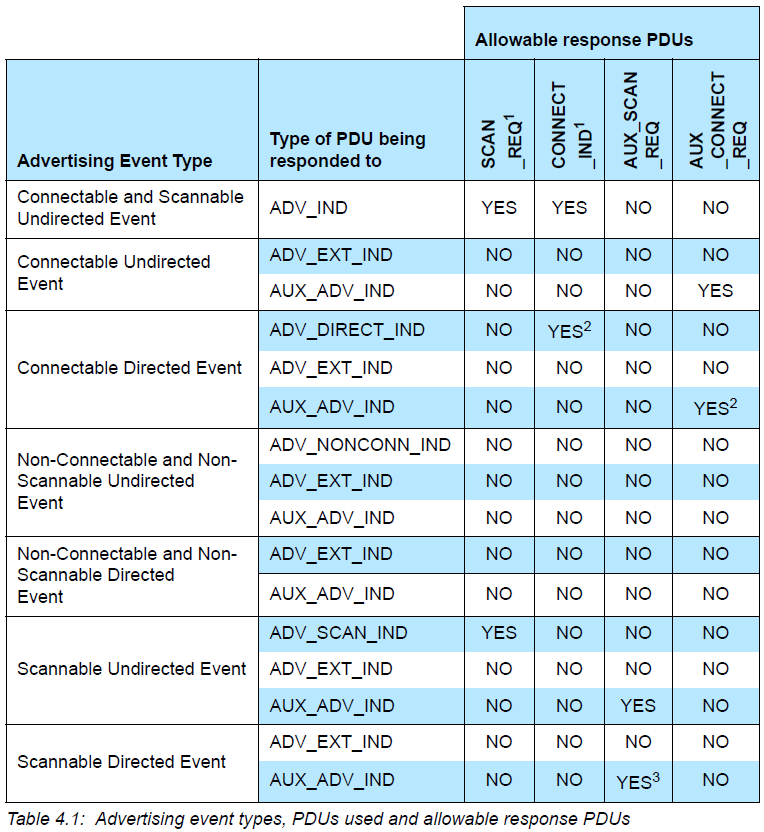

Also from BLE SIG V5.3 Doc i found this->
So What i understand is we can't use both connectable and scannable in BLE Extended advertising.
Could you please confirm this ?

5,522 Views
EduardoZamora
Your understanding is correct. According to the Bluetooth 5.0 Specification, advertising cannot be scannable and connectable at the same time for this type of advertisement.
Eduardo.
