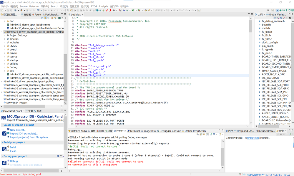

IDE circumstance.pngerror occur when debugging.pngHello there:
                   The FRDM-KW36 went well when I debugged ADC demo, while after I loaded the 'frdmkw36_wireless_examples_bluetooth_health_t_bm' into the develop board, the error occured as fllowing:
Unable to connect wire for probe index 1.
Error: Wire Ack Fault - target connected?
at com.nxp.mcuxpresso.core.debug.support.linkserver.redlink.client.RedlinkServerClient.checkServerReply(RedlinkServerClient.java:224)
at com.nxp.mcuxpresso.core.debug.support.linkserver.redlink.client.RedlinkServerClient.wireConnect(RedlinkServerClient.java:1192)
at com.nxp.mcuxpresso.core.debug.support.linkserver.emulators.jtag.AbstractJtagDiscovery.ideConnect(AbstractJtagDiscovery.java:232)
at com.nxp.mcuxpresso.core.debug.support.linkserver.emulators.jtag.AbstractJtagDiscovery.connect(AbstractJtagDiscovery.java:196)
at com.nxp.mcuxpresso.core.debug.support.linkserver.emulators.jtag.AbstractJtagDiscovery.discover(AbstractJtagDiscovery.java:155)
at com.nxp.mcuxpresso.core.debug.support.linkserver.emulators.TargetDiscovery.jtagDiscovery(TargetDiscovery.java:454)
at com.nxp.mcuxpresso.core.debug.support.linkserver.launch.LaunchScriptUtils.getEmulatorInfo(LaunchScriptUtils.java:257)
at com.nxp.mcuxpresso.core.debug.support.linkserver.launch.LaunchScriptUtils.init(LaunchScriptUtils.java:497)
at com.nxp.mcuxpresso.core.debug.support.linkserver.launch.LaunchScriptUtils.<init>(LaunchScriptUtils.java:165)
at com.nxp.mcuxpresso.core.debug.support.linkserver.launch.LaunchScriptUtils.<init>(LaunchScriptUtils.java:152)
at com.nxp.mcuxpresso.core.debug.support.linkserver.services.TargetDiscoveryService.getTargetDiscovery(TargetDiscoveryService.java:138)
at com.nxp.mcuxpresso.core.debug.support.linkserver.override.LSFinalLaunchSequence$TargetDiscoveryJob.run(LSFinalLaunchSequence.java:124)
at org.eclipse.core.internal.jobs.Worker.run(Worker.java:63).
It seems that the chip on board cannot connect to MCUXpresso IDE v11.6.1_8255, while the flashed BLE demo operates normally. So may some engineer can solve the problem for me?

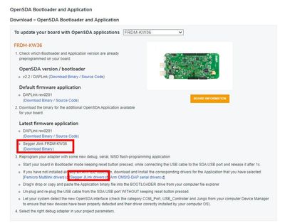

FRDM-KW38 has integrated OpenSDA inside, so you can use J-Link by entering BOOTLOADER mode to burn firmware.
1. Download the bin file for the corresponding board at this link.
2. Connect the jumper to J5 pin1. Follow the above picture to enter BOOTLOADER mode and burn the binary file.
3. After that, move the jumper to J35 pin1. Then you can debug via J-Link.
Please have a try.

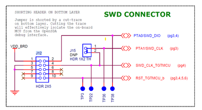

Hi Gavin:
When I connect chip by J-Link Commander, after I choose MKW36Z512xxx4 in Target device settings,  the app did not identify the core of the board, so I cannot use command unlock kinetis. By the way, I connect the board through J12, as the fllowing fig:
I connect pin 1, 5, 2 and 4 to the Jlink, is there mistake I have made?

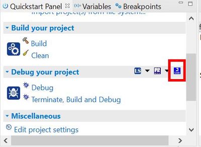

Hi Gavin:
              The alternative method with J-link applied is useful and the board works normally again. I  really appreciate your help.
10,677 Views
Gavin_Jia
Just as a hint, here's a simple solution. While you are debugging via J-Link, operating in MCUXpresso is ok.

Hi:
     Creat new workspace did not  help. And steps I run the GUI Flash Tool are showen as following:
Unfortunately, the error still exists. So is it the only solution to get a Jlink for erasing the chip? It's not convient for me case epidemic control of COVID19
