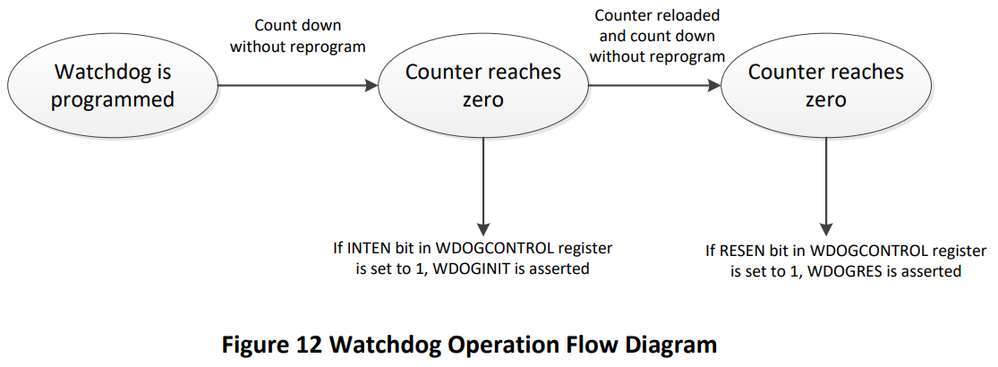

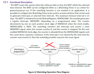

I am using Q9021 and BLE SDK 1.0.0. I set the watchdog timer to 5 seconds. I made an infinite loop to test the watchdog. But it resets after 10 seconds. How can I make the watchdog time 5 seconds? How to remove the intermediate stage as shown. The code snippet is as follows.

QN9021 SDK version 1.0.0 is out of date, would it be possible for your application to migrate to SDK version 1.4.0? Also, please consider that QN9090/30 is preferred for any new design.
This should be an expected behavior. As you mentioned, User Manual of QN902x [UM10996] Chapter 13 Watch-Dog Timer describes that the module generates a regular interrupt (WDOGINT), the watchdog monitors the interrupt and asserts a reset (WDOGRES) signal, when the counter reaches 0, and the counter is stopped. You can find a WDT demo inside QN902x SDK 1.4.0 > Projects > Driver > wdt.

According to the WDT operation flow, reset signal is asserted after WDOGINT is asserted and the counter reaches zero / is stopped.
