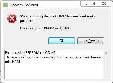

Hi! I´m trying to build an application for the JN5168 with JN-AN-1171. everytime I try to programm the JN5168 I get the following message:
The strange thing is I had no trouble before. I use a jn5168.bin file so it schould be compatible. It loaded earlyer without problem!

Hi Dirk,
Could you please close and open the Beyond Studio IDE?
Also, disconnect the JN device and connected after the IDE was opened.
The IDE probably saved some setup. But it should restart without any problem
Please let me know if you still have this issue.
Mario
2,312 Views
dirk_van_grunsv
Turning the pc on and off did the trick. Thank you!
