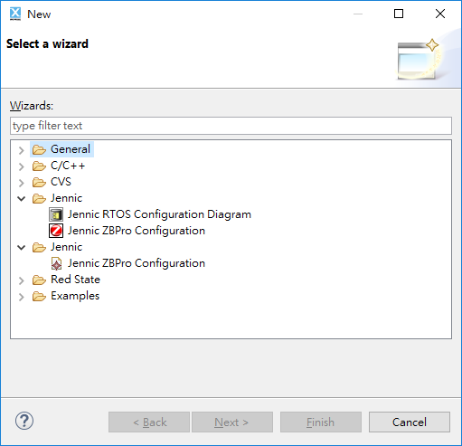

Hello Mario,
It works and got as below wizard. Thank you!
It is the same procedure as Danny described in Section 1.2.2 of JN-UG-3109.
Just wondering why my previous installation of JN-SW-4270 did not include this? I rember to have followed Section 3.2 "SDK Plug-in Installation" of "JN-RN-0062-JN-SW-4270-JN517x-ZigBee3-SDK.pdf", but only to found "All items are installed" message displayed under "NXP RFCS JN-SW-4270 Software Development Kit".
