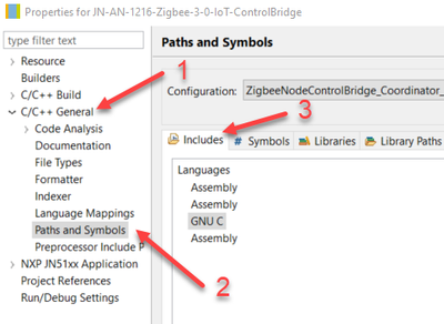

Hi y'all.
I just imported a project for my JN5168 and i'm getting this error message when compiling:
Description	Resource	Path	Location	Type
Invalid project path: Duplicate path entries found (/nd007-firmware [Include path] isSystemInclude:true includePath:C:/NXP/bstudio_nxp/sdk/JN-SW-4170/Components/Common/Include), path: [/nd007-firmware].	nd007-firmware		pathentry	Path Entry Problem
Does anyone knows how to fix this problem? I tried to find the "isSystemInclude" property but no results.
Best Regards!
8,574 Views
EduardoZamora
Please, open the Project properties and go to C/C++ General (left side of Properties window) > Paths and Symbols.
In Includes tab, look for the directory that can be causing the duplicate warning (or any other duplicated directories) and try deleting it.
Eduardo.

EduardoZamora
Eduardo.
8,564 Views
ffonck96
Hi @EduardoZamora .
You were right about the duplicate paths. I had like 10 duplicate paths and 3 symbols too.
Now it can compile without having the duplicate path problem. However, several errors and new warnings are visible.
I want to know if there's another way to make this work or am i missing something?
Regards!
