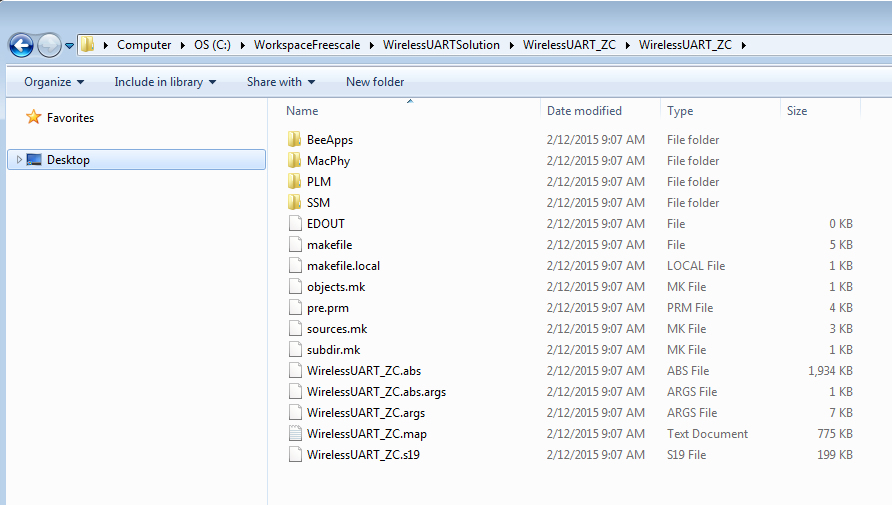

I create 'WirelesUART' example (without modify) on the BeeKit and export to CodeWarrior, and built.
It create binary files without error as below picture
the .abs is 1934KB and .s19 is 199KB
Witch one is binary files for MC13237?
--My target device (MC13237) has 128KB max (Flash).
2,088 Views
AngelC
Senior Contributor I
Dear Min,
The binary for MC13237 is the WirelessUART_ZC.s19 file in this case. You could simply select a debug  configuration in Codewarrior and load such code to the board using  a USB multilink that came with your kit.
