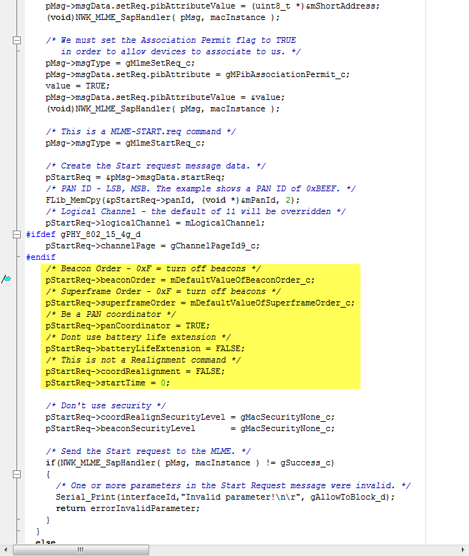

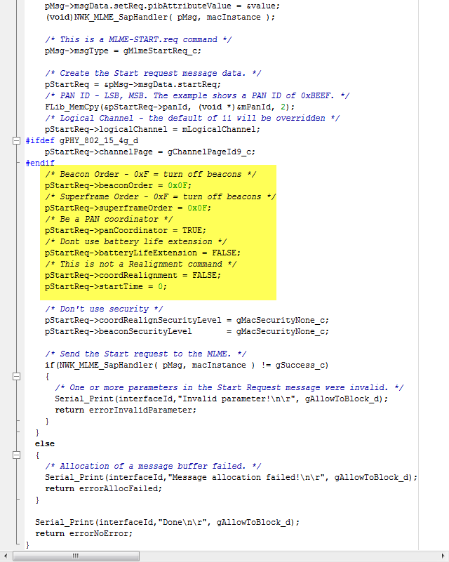

I am trying to create beacon enabled network with KW01 connectivity software. I have tried different beacon and superframe orders with no success. It looks like coordinator does not sending any beacons because passive scan on end device returns with status g_NoBeacon_c, scanDuration is greater than beaconOrder on coordinator, #define gBeaconEnabledSupport_d 1 is set in app_preinclude.h.

Please take as reference the KW41 MyWirelessAPP beacon enabled example. You can set the beacon enabled modifying the c and h files.
KW41 MyWirelessApp Beacon Enabled example. app.c
C:\NXP\MKW41Z_ConnSw_1.0.2\boards\frdmkw41z\wireless_examples\ieee_802_15_4\mwa_coordinator_be
KW01 Coordinator example app.c
C:\Freescale\KW01_Connectivity_Software_1.0.0\ConnSw\examples\ieee_802_15_4\MyWirelessApp

Thank you for replay. I have made test according to KW41 MyWirelessAPP beacon enabled example, but still no success with passive scan on end device. In KW41 example linked library is: "802.15.4_mac_06begts_cM0_IAR.a". Connectivity software for KW01 has no library with letters "be" in filename (i.e. beacon enabled). I believe that there is no support for beacon enabled network in precompiled 802.15.4 libraries for KW01. Is it possible to get more recent 802.15.4 libraries for KW01 with beacon enabled network support?
