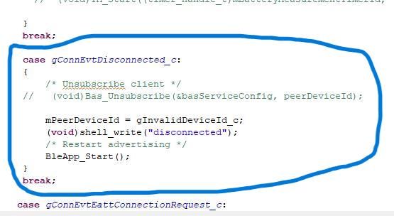

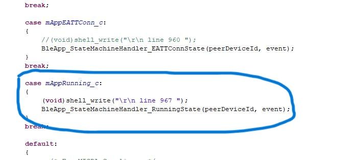

I am using EATT Peripheral example for transmitting data through EATT (BLE) but as soon as I add one more custom service (already 2 are present) and same changes I implemented in central side also for debug, EATT Pheripheral is unable to accept EATT connection request from central. Could you please help me in implementing 3rd custom services in Peripheral side and what changes are required in central part to receive the data I would like to tell I have updated code in store service handle to receive UUID and it is reading 3rd custom service UUID and it is transmitting EATT request too from central, but Peripheral is getting disconnected rather than accepting eatt connection request.
i attached screenshot where its entering to disconnect case than entering to MApp_running_c .

If you are trying to implement a custom profile I would recommend consulting the information in this community post KW38 Custom Profile - NXP Community this is destined for the KW38 but the steps to follow apply for the KW45 implementing the data, Please refer to client section to modify the peripheral in your project.
Also, you can consult the detailed information on custom profiles in the Developers Guide Chapter 8 Bluetooth Low Energy Application Developer’s Guide
If you would like to reference an example that implements multiple services, I would recommend checking the Private Profile Server/Client examples from the QN9080 SDK, the application implements a custom GATT based Private Profile for Battery Service, Device Info Service and Private Profile service and can send data from client to server.
