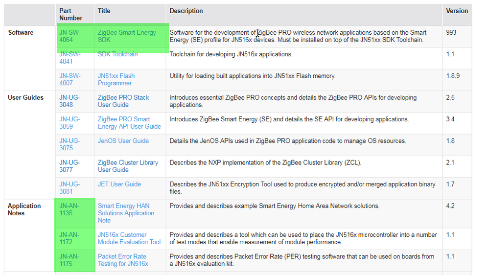

mario_castaneda
Hi Vihang,
What is the link where you are downloading the SDK and the AN?
ZigBee Smart Energy|NXP
Smart Energy SDK JN-SW-4064
The AN that we provide are:

mario_castaneda
Hi Vihang,
I'm sorry. Could you please confirm the SDK and the JN-AN-xxxx version?
