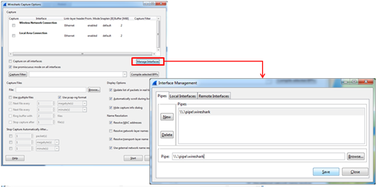

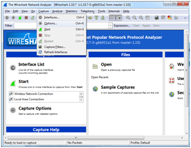

4. Setting Wireshark
  • Start Wireshark and open Capture>Options Dialog
  • Click on “Manage Interfaces” and add a new pipe with ‘\\.\pipe\wireshark’. Save it and start capture.

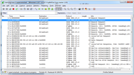

5. Start sniffing
