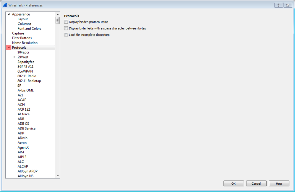

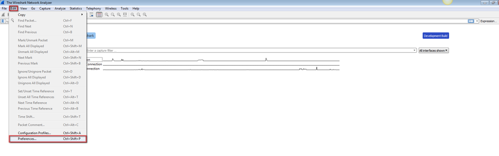

  2. Click Edit and select Preferences
  3. Click Protocols to expand a list of protocols

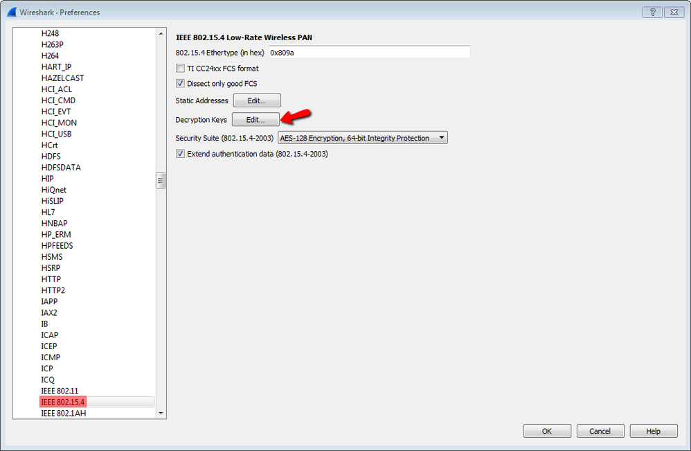

  4. Select IEEE 802.15.4, click the Decryption Keys Edit... button
  5. Create a new key entry by pressing the plus button, then set the following values and click OK
         Decryption key = 00112233445566778899aabbccddeeff
         Decryption key index = 1
         Key hash = Thread hash

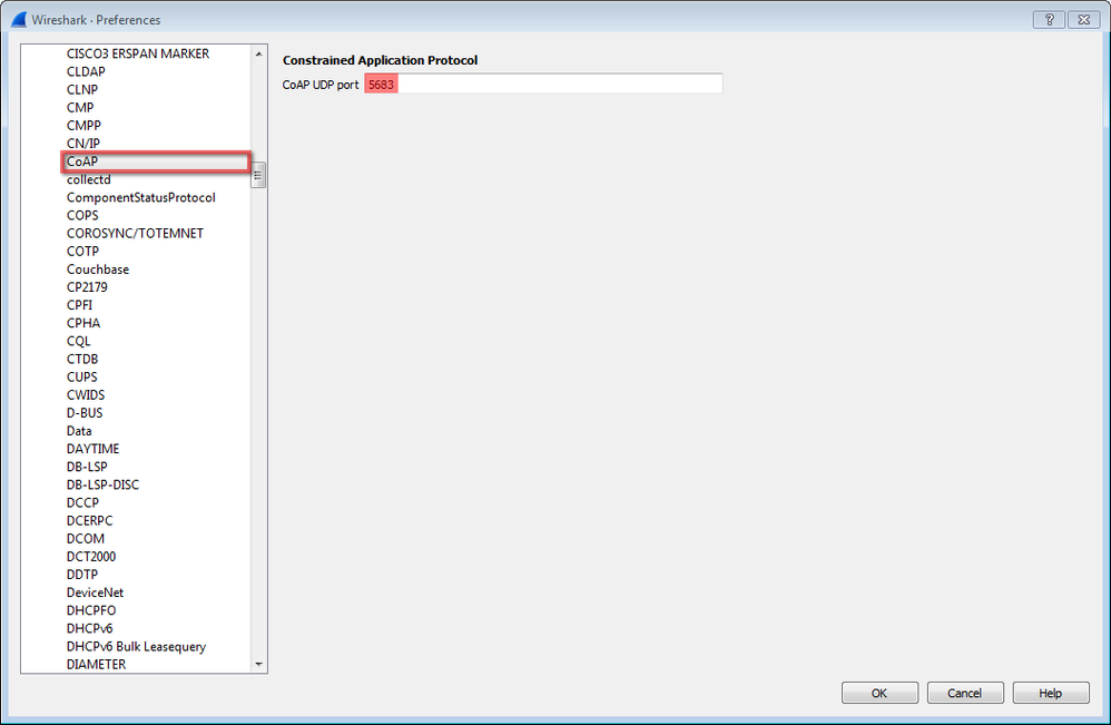

  6. Find CoAP and configure it with CoAP UDP port number = 5683

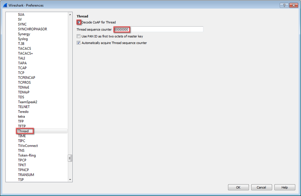

  7. Click Thread and select Decode CoAP for Thread  with Thread sequence counter = 00000000 as shown below

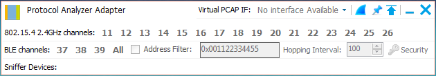

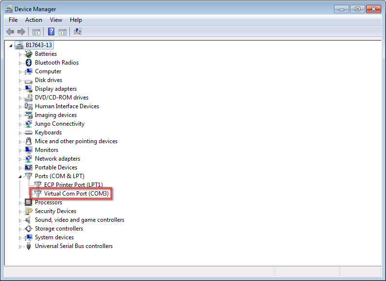

  1. Connect the USB-KW41Z to one of the USB ports on your computer
  2. Open the device manager and look for the device connected port

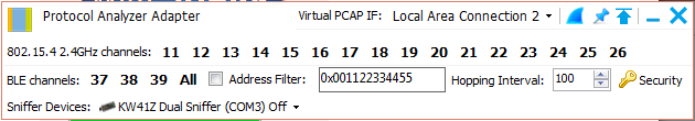

  3. Open the "Kinetis Protocol Analyzer Adapter" program
  4. Make sure, you have a USB-KW41Z connected to your PC when opening the program because the Kinetis Protocol Adapter will start looking for kinetis sniffer hardware. Once the USB-KW41Z is detected, the previously identify COM port will be displayed

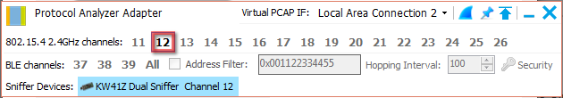

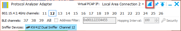

  5. Select the desired IEEE 802.15.4 channel to scan in the Kinetis Protocol Analyzer window. This guide selects channel 12 as an example
  6. Click on the Wireshark icon to open Wireshark Network Protocol Analyzer

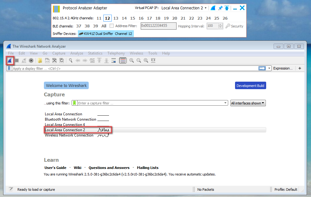

  1. Wireshark Network Analyzer will be opened. On the "Capture" option of the main window, select the Local Area Connection that was created by the Kinetis Protocol Analyzer, in this example, Kinetis Protocol Analyzer created "Local Area Connection 2", then click "Start" button.pastedImage_32.png
  2. USB-KW41Z will start to sniff and upcoming data will be displayed in the "Capture" window of the Wireshark Network Protocol Analyzer.
