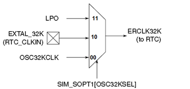

You must understand that the RTC module can work with different clock sources (LPO,EXTAL_32K and OSC32KCLK) and it can be reflected through the RTC_CLKOUT pin. The register that change the clock source is the SIM_SOPT1 with OSC32KOUT(17-16) and OSC32KSEL(19-18) these are the names of the register bits.
The OSC32KOUT(17-16) enable/disable the output of ERCLK32K on the selected pin in our case is the PTB3. You can configure with two options.
00     ERCLK32K is not output.
01     ERCLK32K is output on PTB3.
The OSC32KSEL(19-18) selects the output clock, they have 3 option like show in the next image.
Figure 2. Mux of the register SIM_SOPT1

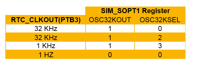

The follow table show the different outputs that you can get in the RTC_CLKOUT pin, you only have to modify the OSC32KOUT and OSC32KSEL in the register SIM_SOPT1.
Figure 3. Output of RTC_CLKOUT pin.

SIM_SOPT1 = SIM_SOPT1_OSC32KOUT(0)|SIM_SOPT1_OSC32KSEL(0);
     //Your RTC_CLKOUT is 1Hz with this configuration
