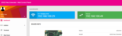

You have connected your Udoo Neo board to an Ethernet cable, just open a new terminal to be sure that you have a connection. You could type the ping 8.8.8.8 command.
If you do not have the IPV4, you could access connection your board to your computer and use the USB IP. After that, you could open a browser and enter to the Udoo Neo page using the USB IP. You could use the different address for creating a SSH connection.

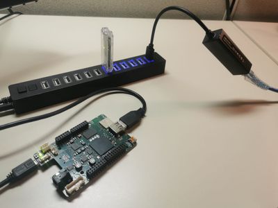

In this case, the UDOO NEO Extended doesn't have an Ethernet port, so, there is a USB converter to Ethernet. The OpenThread Example requires an IPV6 address

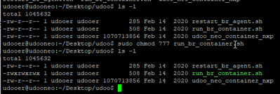

sudo ./run_br_container.sh;
Note: You have to have Ethernet Connection because the OpenThread requires IPV6.
Be sure that the file has the execute permissions.

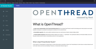

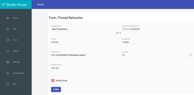

After that, open a browser and search the IPV4 of your UDOO Neo, and you will find an OpenThread web page.
On the left side, select the option form, and a new page will be displayed for the network creation.
Then you can ask for the wpanctl status, it will show all the Thread information, the address, the channel of the network, etc.

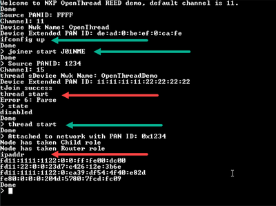

Node B
Flash another JN5189/K32W using the REED example and type the next command for enabling and join to a Thread Network.
\K32W061DK6\boards\k32w061dk6\wireless_examples\openthread\reed
ifconfig up
joiner start J01NME
After the joining process is complete, type the next command to attach to the border router.
thread start
Look at the image below, you will notice the Node B Commands.
Ping the external internet 64:ff9b::808:808 to be sure that you have access to the internet.
