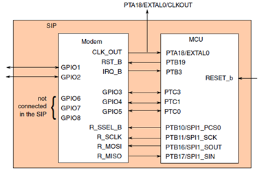

By default the clock configuration on the KW2xD demos is set to PLL Engaged External (PEE). In this mode the system clock is derived from the output of the PLL and controlled by an external reference clock. The modem provides a programmable clock source output CLK_OUT that can be used as the external reference clock for the PLL. In the Figure 1 we can see that the CLK_OUT modem signal is internally connected to EXTAL0 in the MCU.
The CLK_OUT output frequency is controlled by programming the modem 3-bit field CLK_OUT_DIV [2:0] in the CLK_OUT_CTRL Register. The default frequency is either 32.787 kHz or 4 MHz depending on the state of the modem GPIO5 at reset determined by the MCU. See section 4.4.2 and 5.6.2 from the MKW2xD Reference Manual for more information on the clock output feature.

In the KW2xD demos, the GPIO5 (PTC0) is held low during the modem reset so the CLK_OUT has a frequency of 4MHz. The clock configuration structure g_defaultClockConfigRun is defined in board.c.
Figure 1. Internal Functional Interconnects

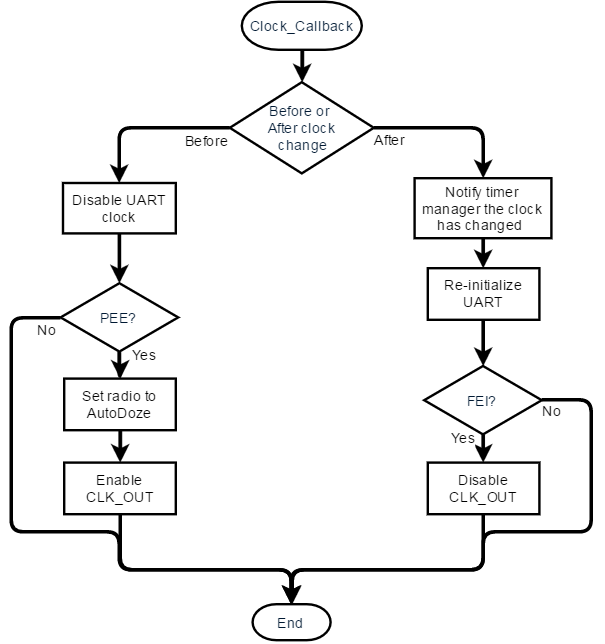

The Clock_Callback() function was implemented to handle when the clock configuration is updated. Inside the function there is a case to handle before and after the clock configuration is changed. Before the clock configuration is changed, the UART clock is disabled and if the clock configuration is PEE, the radio is set to AutoDoze and the CLK_OUT is enabled. After the clock configuration has changed, the Timer module is notified that the clock has changed, the UART is re-initialized and if the clock configuration is FEI, the CLK_OUT is disabled. This behavior is shown in Figure 2.
