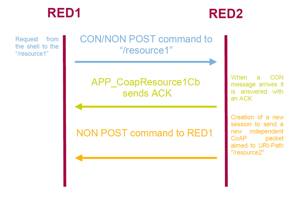

  • Add 2 new COAP URI resources “/resource1” and “/resource2”.
  • Send an ACK message in “/resource1” in case a CON request was received as specified by the CoAP standard. Include a default payload in the ACK message.
  • All packets destined to “/resource1” will trigger a NON POST packet reply (independent from the expected ACK packet) destined to “/resource2” URI path with a default payload.
  • Print in shell all CoAP transactions to fully understand when a request was sent and when a response was received, indicating the method and the resource, e.g.
  • If a CON POST was received, print on shell “‘NON’ packet received, ‘POST’ with payload of ‘<payload>’
  • If a NON POST was sent, print on shell “‘NON’ packet sent, ‘POST’ with payload ‘<payload>’
The process desired behavior by the laboratory is shown in figure 1.

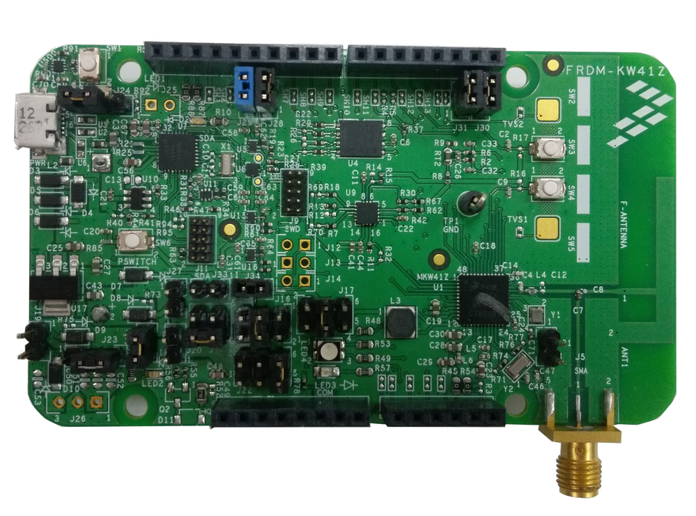

  • 2 FRDM-KW41Z
      — Rev.  A
  • Connectivity Software from the latest NXP release.
      — Thread Router Eligible Device project
  • Serial Terminal
      — TeraTerm
Figure 2 FRDM-KW41Z

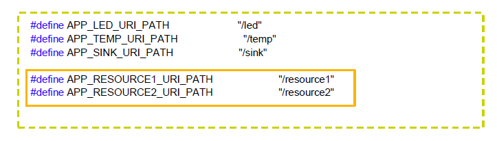

1. Define the URI path names that will be used in the shell to access the resources.
#define APP_RESOURCE1_URI_PATH                       "/resource1"
#define APP_RESOURCE2_URI_PATH                       "/resource2"

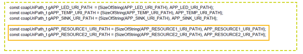

2. Declare the URI resources with coapUriPath_t. When using this struct the user must enter the length of the URI path and the path created in the last step.
const coapUriPath_t gAPP_RESOURCE1_URI_PATH = {SizeOfString(APP_RESOURCE1_URI_PATH), (uint8_t *)APP_RESOURCE1_URI_PATH};
const coapUriPath_t gAPP_RESOURCE2_URI_PATH = {SizeOfString(APP_RESOURCE2_URI_PATH), (uint8_t *)APP_RESOURCE2_URI_PATH};

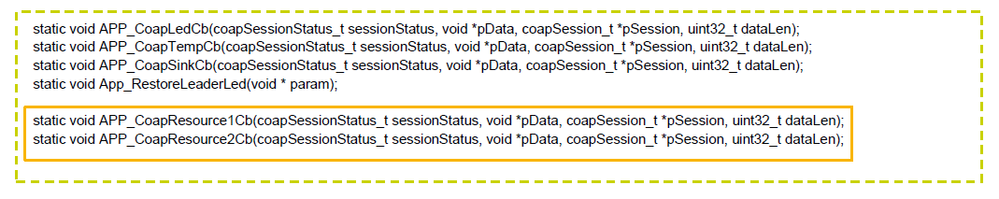

3. Create the callbacks for the resources. This callbacks will handle the packet received and perform the desired action depending on the type of COAP method received.
static void APP_CoapResource1Cb(coapSessionStatus_t sessionStatus, void *pData, coapSession_t *pSession, uint32_t dataLen);
static void APP_CoapResource2Cb(coapSessionStatus_t sessionStatus, void *pData, coapSession_t *pSession, uint32_t dataLen);

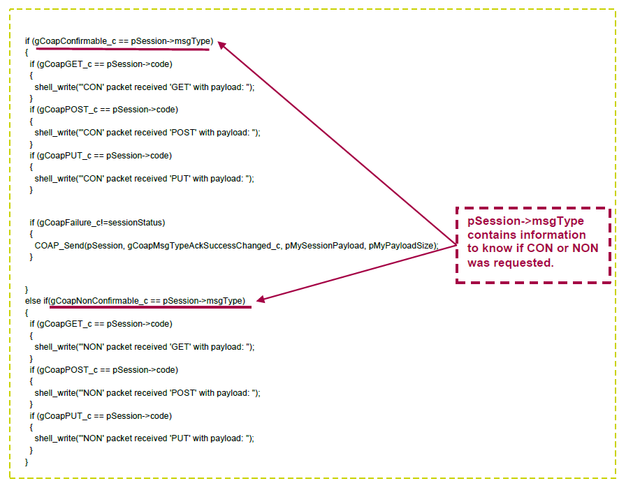

4. Add the callback handler for the packet received, in this function it will be defined which action will be performed depending on the type of COAP method received.
  • APP_CoapResource1Cb

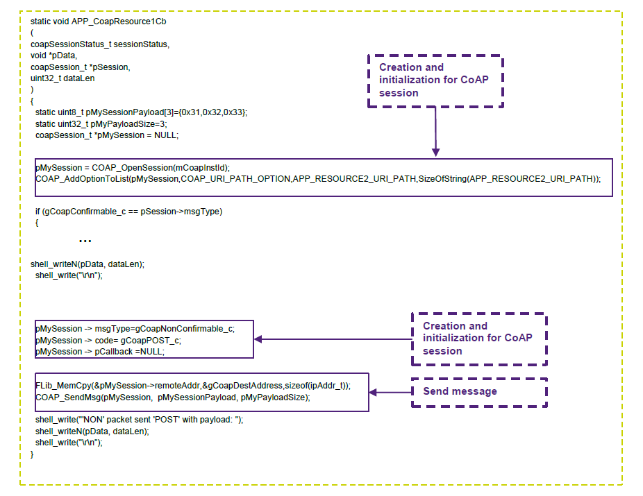

void *pData,
uint32_t dataLen

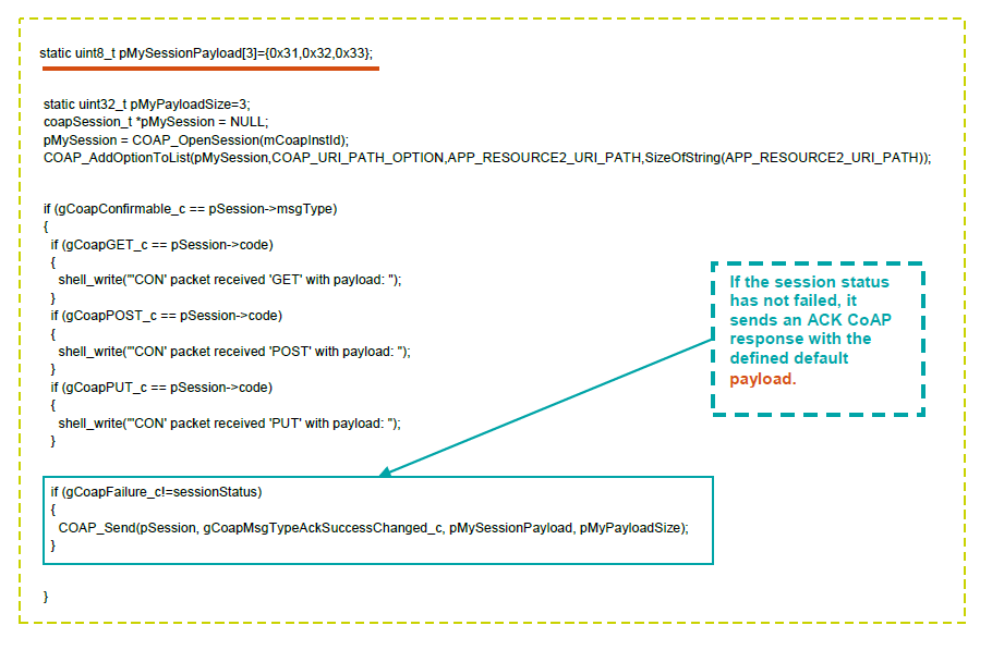

  static uint8_t pMySessionPayload[3]={0x31,0x32,0x33};
  static uint32_t pMyPayloadSize=3;
  coapSession_t *pMySession = NULL;
  pMySession = COAP_OpenSession(mAppCoapInstId);
  //COAP_AddOptionToList(pMySession,COAP_URI_PATH_OPTION, APP_RESOURCE2_URI_PATH,SizeOfString(APP_RESOURCE2_URI_PATH));
  pMySession->pUriPath = (coapUriPath_t *)&gAPP_RESOURCE2_URI_PATH;

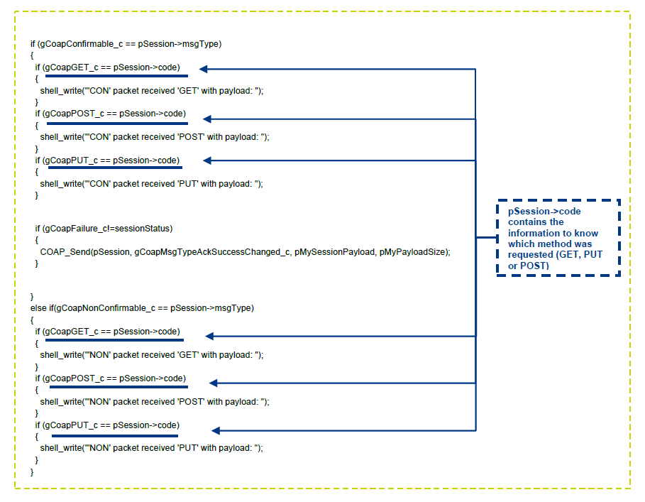

    if (gCoapConfirmable_c == pSession->msgType)   {     if (gCoapGET_c == pSession->code)     {       shell_write("'CON' packet received 'GET' with payload: ");     }     if (gCoapPOST_c == pSession->code)     {       shell_write("'CON' packet received 'POST' with payload: ");     }     if (gCoapPUT_c == pSession->code)     {       shell_write("'CON' packet received 'PUT' with payload: ");     }         if (gCoapFailure_c!=sessionStatus)     {       COAP_Send(pSession, gCoapMsgTypeAckSuccessChanged_c, pMySessionPayload, pMyPayloadSize);     }   }   else if(gCoapNonConfirmable_c == pSession->msgType)   {     if (gCoapGET_c == pSession->code)     {       shell_write("'NON' packet received 'GET' with payload: ");     }     if (gCoapPOST_c == pSession->code)     {       shell_write("'NON' packet received 'POST' with payload: ");     }     if (gCoapPUT_c == pSession->code)     {       shell_write("'NON' packet received 'PUT' with payload: ");     }      }   shell_writeN(pData, dataLen);   shell_write("\r\n");   pMySession -> msgType=gCoapNonConfirmable_c;   pMySession -> code= gCoapPOST_c;   pMySession -> pCallback =NULL;   //FLib_MemCpy(&pMySession->remoteAddr,&gCoapDestAddress,sizeof(ipAddr_t));
FLib_MemCpy(&pMySession->remoteAddrStorage.ss_addr, &gCoapDestAddress, sizeof(ipAddr_t));
  //COAP_SendMsg(pMySession,  pMySessionPayload, pMyPayloadSize);
COAP_Send(pMySession, gCoapMsgTypeNonPost_c, pMySessionPayload, pMyPayloadSize);   shell_write("'NON' packet sent 'POST' with payload: ");   shell_writeN((char*) pMySessionPayload, pMyPayloadSize);   shell_write("\r\n"); }

There can be multiple COAP sessions per instance, a COAP session is per packet/transaction. In this case as the desired result was to have a different response of the ACK, it will be necessary to create a new session with the new resource.

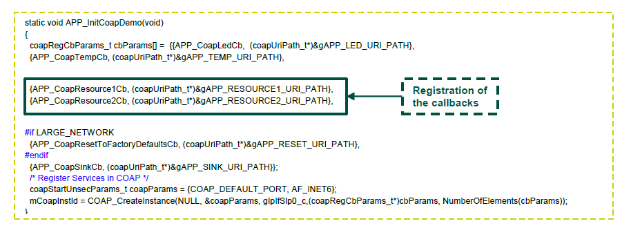

5. After creating the callbacks, those must be registered in the CoAP callback array in the function APP_InitCoapDemo(void)
{APP_CoapResource1Cb, (coapUriPath_t*)&gAPP_RESOURCE1_URI_PATH},
{APP_CoapResource2Cb, (coapUriPath_t*)&gAPP_RESOURCE2_URI_PATH},

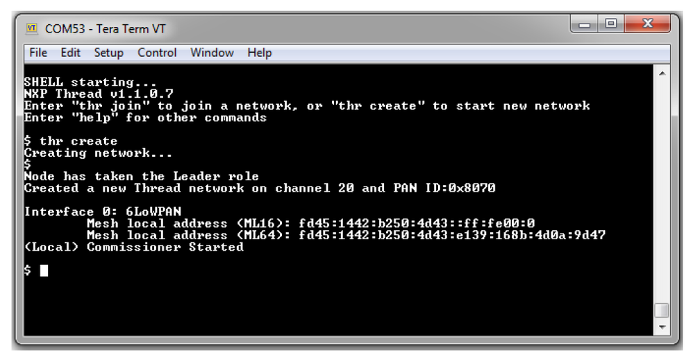

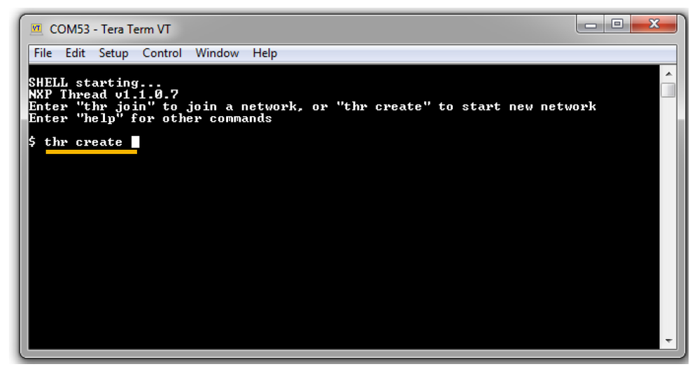

3. In one of the board’s terminal type “thr create”, this board will be the leader.
Figure 4 Board 1 with command "thr create"
Figure 5 Board 1 after the command "thr create"

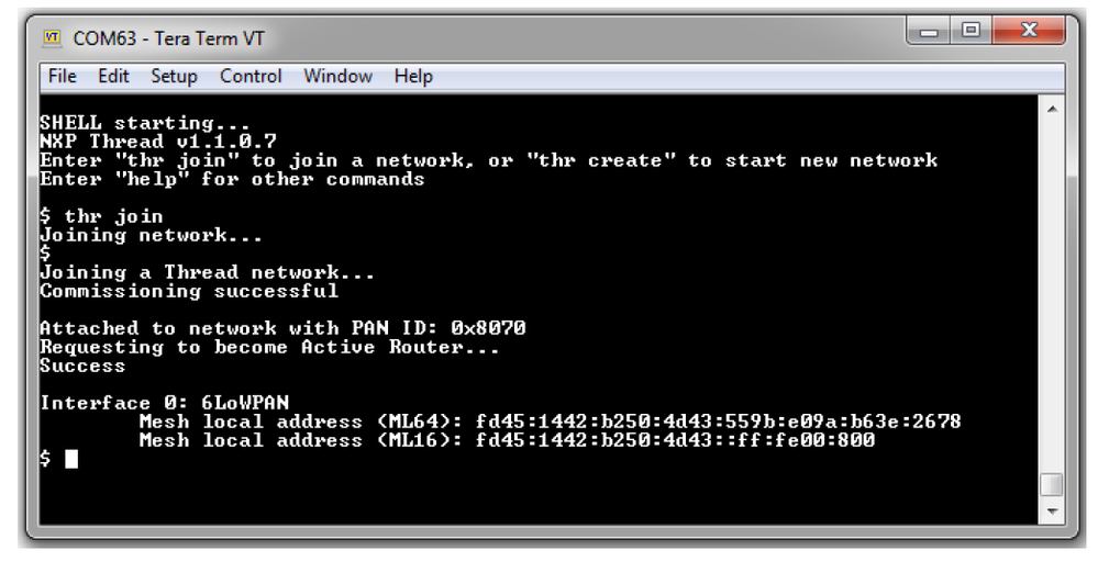

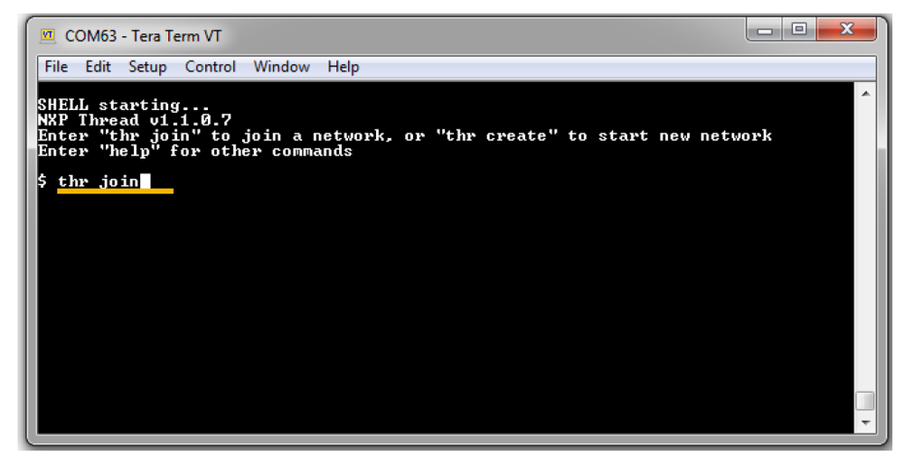

4. Once the network has been created type “thr join” in the second board’s terminal.
Figure 6 Board 2 with command "thr join"
Figure 7 Board 2 after command "thr join"

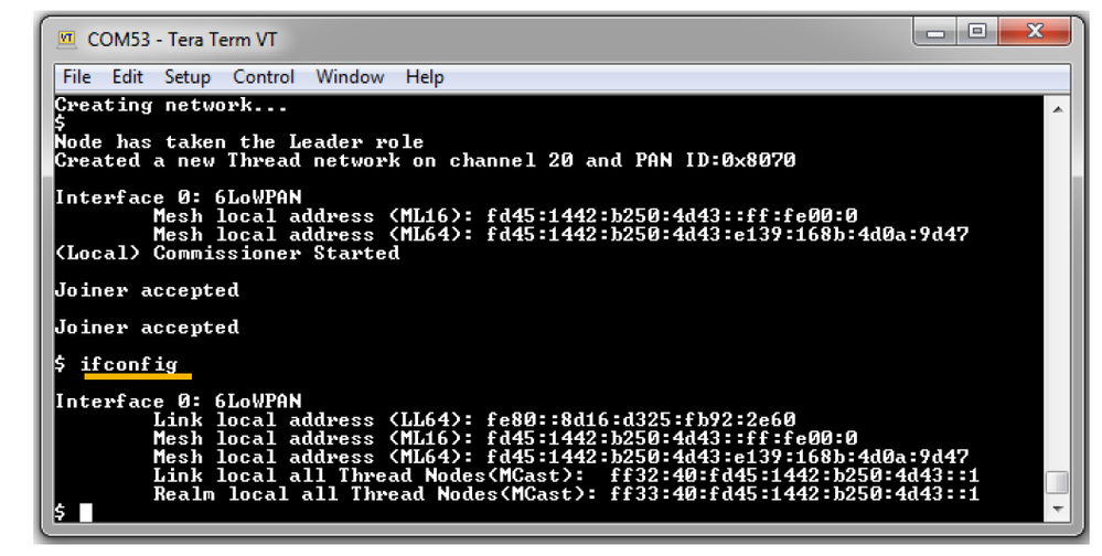

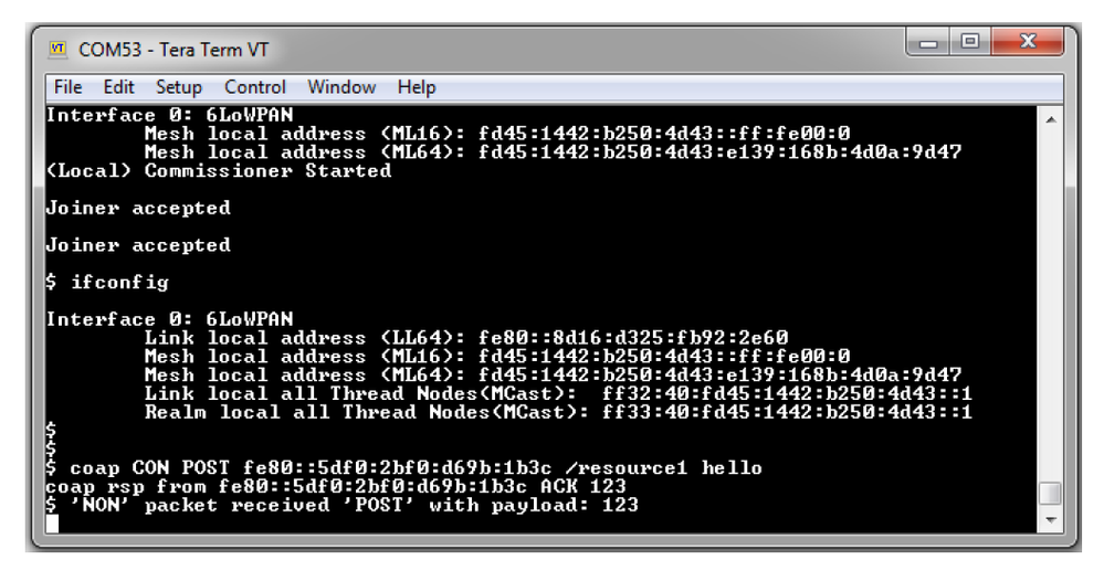

5. In both serial terminals type the command “ifconfig”. This command will display all the addresses of the board.
Figure 8 Board 1 after command "ifconfig"
Figure 9 Board 2 after command "ifconfig"

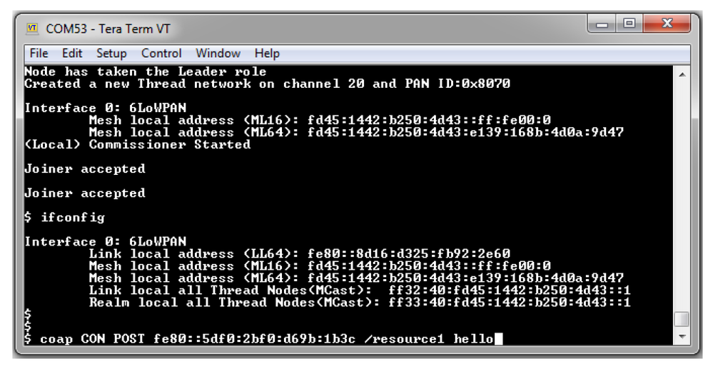

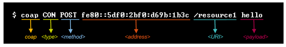

6. To test the callbacks created, a CoAP message must be sent. The following command must be typed;
coap <type> <method> <address> <URI> <payload>
coap CON POST fe80::5df0:2bf0:d69b:1b3c  /resource1 hello
Figure 10 CoAP command to send
7. The result of sending must look like :
— Board 1
The board 1 will request the board 2 the resource1
Figure 11 Board 1 before sending the CoAP command
As it was coded the other board will send an ACK and print the message.
Figure 12 Board 1 after sending the CoAP command
— Board 2
Figure 13 Board 2 after receiving the CoAP command
If using the CON message the requester board will receive a response, while if the message is a NON type it will not have the response.
