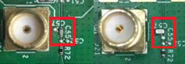

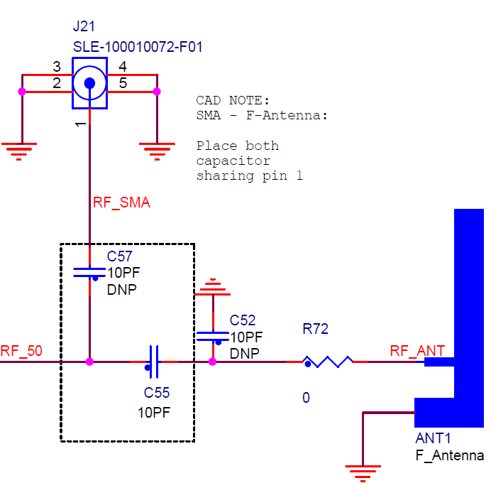

- In case that FRDM-KW36 board is being used to perform the test, you should move the 10pF capacitor populated in C55 to C57, to direct the RF signal on the SMA connector.

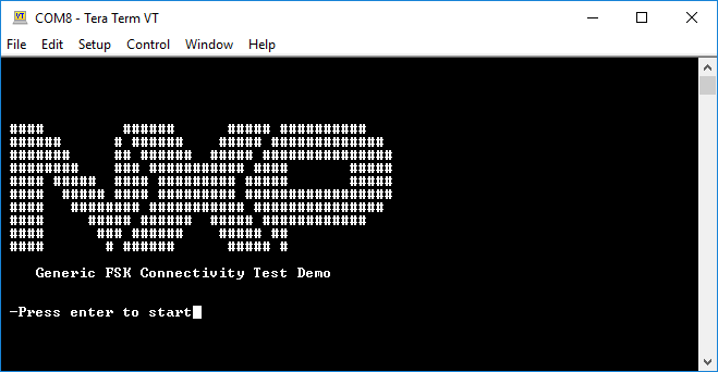

- Connect the board to a serial terminal software. When you start the application, you will be greeted by the NXP logo screen:

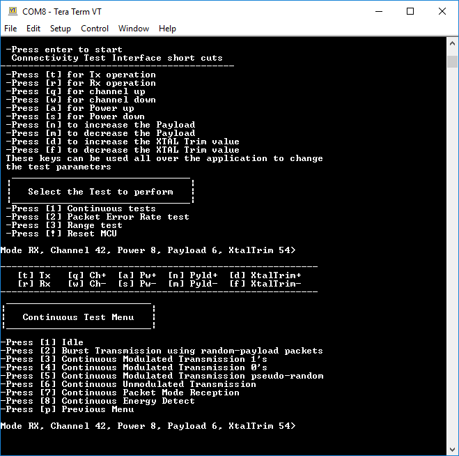

- Press the enter key to start the test. Then press "1" to select "Continuous tests":

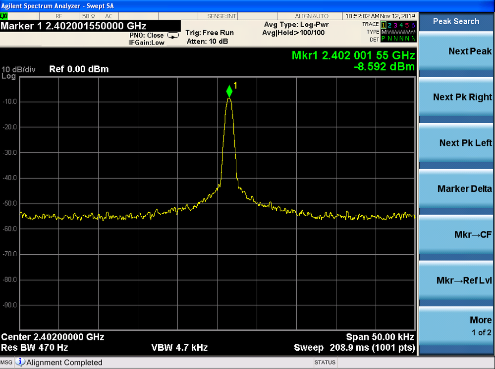

- Finally, select "6" to start a continuous unmodulated RF test. At this point, you should be able to measure the signal in the spectrum analyzer. You can change the RF channel from 0 to 127 ("q" Ch+ and "w" Ch- keys), which represents the bandwidth from 2.360GHz to 2.487GHz, stepping of 1MHz between two consecutive channels. To demonstrate the trimming procedure, this document will make use of channel 42 (2.402GHz) which corresponds to the Bluetooth LE channel 37. In this case, with the default capacitance value, our oscillator is not exactly placed at the center of the 2.402GHz, instead, it is slightly deflected to 2.40200155 GHz, as depicted in the following figure:

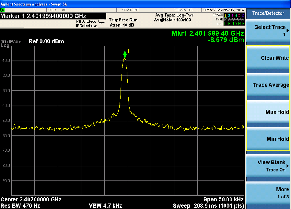

- The capacitance can be adjusted with the "d" XtalTrim+ and "f" XtalTrim- keys. Increasing the capacitance bank means a lower frequency. In our case, we need to increase the capacitance to decrease the frequency. The nearest frequency of 2.402 GHz was 2.40199940 GHz
- Once the appropriate XTAL trim value has been found, it can be programmed as default in any Bluetooth LE example, changing the mXtalTrimDefault constant located in the board.c file:
static const uint8_t mXtalTrimDefault = 0x36;
