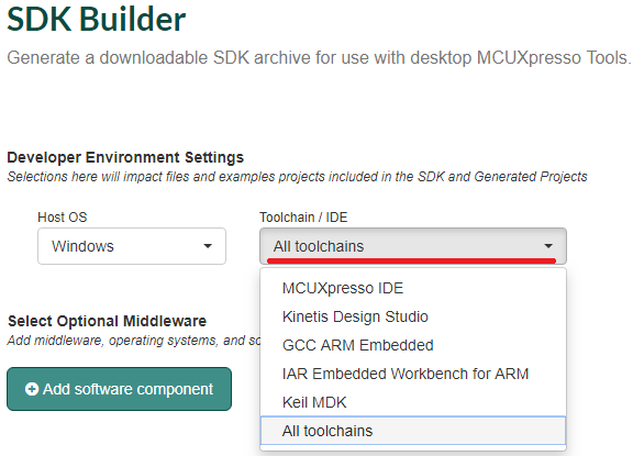

When downloading the SDK, select your specific IDE or simply choose all toolchains as shown below.

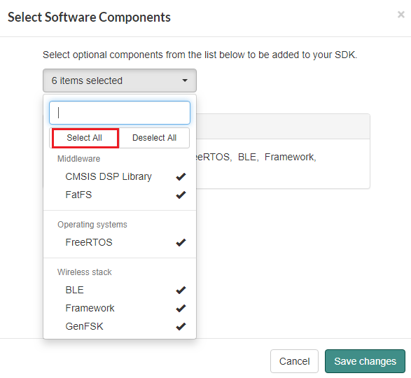

In the option "Add software component", ensure to select all middleware components as depicted below.

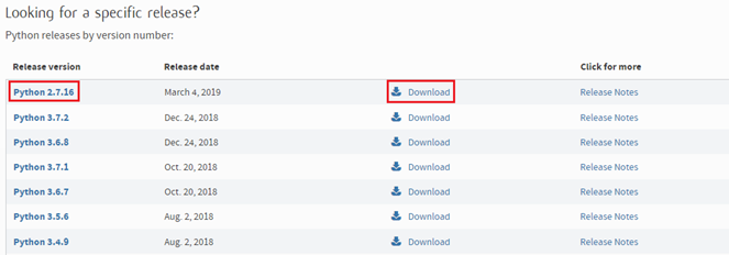

  • Visit the Python web site and download the latest Python 2.7.x MSI installer package for Windows OS.pastedImage_2.png

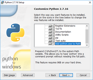

  • Open the MSI installer package. When customizing the installation options, check "Add python.exe to Path" as shown below

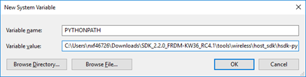

  • To run Python scripts from the Command Prompt of Windows, we must create a system variable named PYTHONPATH. Search “System” in the Windows browser. Go to Advanced system settings -> Environment Variables… -> System variables. Click on the “New…” button and create the PYTHONPATH variable with the following value: <SDK_root>\tools\wireless\host_sdk\hsdk-python\src.pastedImage_23.png

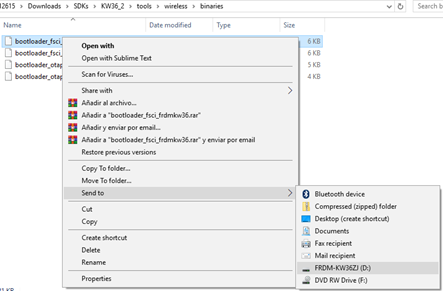

  2. Drag and drop the “bootloader_fsci_frdmkw36.bin” from the previously unzipped SDK file, you can find this file in: <SDK_root>\tools\wireless\binaries to your board. Like a common USB device.pastedImage_31.png

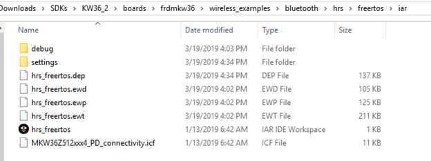

  • Open the connectivity project that you want to program through the FSCI bootloader from your SDK. This example will make use of the heart rate sensor project, located at the following path: <SDK_root>\boards\frdmkw36\wireless_examples\bluetooth\hrs\freertos\iar\hrs_freertos.eww.pastedImage_42.png

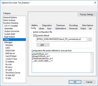

  • Open the project options window (Alt+F7). In Linker -> Config window, edit the “Configuration file symbol definitions” add the “gUseBootloaderLink_d=1” linker flag as shown below.pastedImage_44.png

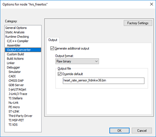

  • Go to the “Output Converter” window and ensure that the output file is in binary format (.bin), otherwise, deselect the “Override default” checkbox, expand the “Output format” combo box and select “Raw binary. Click the OK button.

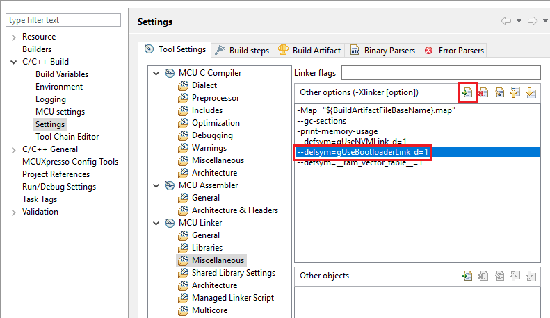

  • Go to Project -> Properties, a new window will appear. Then, open the C/C++ Build -> Settings -> Linker -> Miscellaneous. Press the icon below, a new window will be deployed. Add “--defsym=gUseBootloaderLink_d=1”. Click on “Apply and Close”.pastedImage_2.png

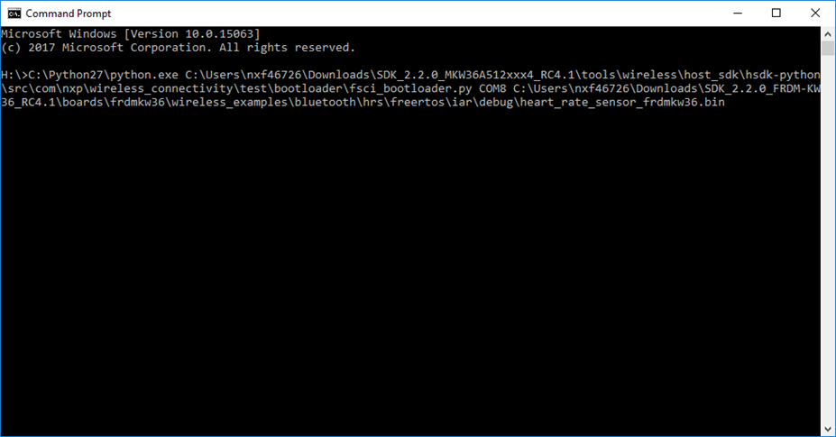

  2. Run the "fsci_bootloader.py" Python script.

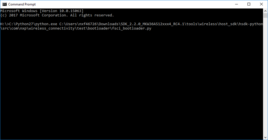

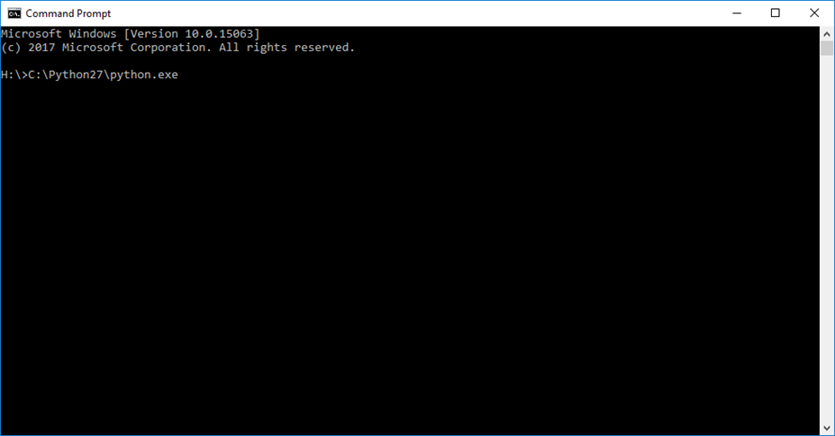

  1. Type the “python.exe” path in the console (default C:\Python27\python.exe).pastedImage_67.png
  2. Drag and drop the “fsci_bootloader.py” from: <SDK_root>\tools\wireless\host_sdk\hsdk-python\src\com\nxp\wireless_connectivity\test\bootloader on the command prompt screen.pastedImage_73.png

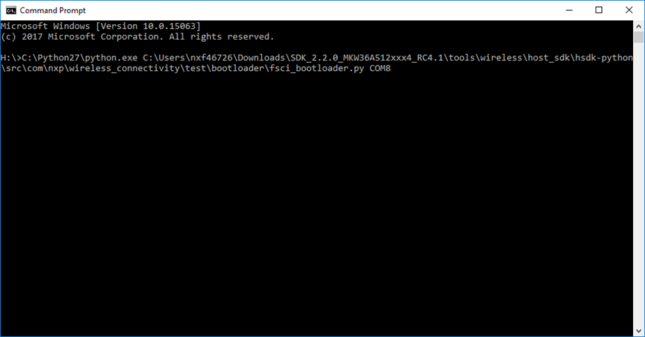

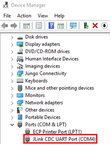

  3. Search the COM Port of your FRDM-KW36 board and type in the console. You can find it typing ‘Device manager’ from windows home and then search it in Ports (COM & LPT) toolbar. As you can see in this example the port may change depending on each case.pastedImage_78.png
  4. Search the binary image file (created in the last section). Drag and drop on the screen.pastedImage_80.png
  5. Press “Enter” to start the firmware update trough FSCI bootloader. Automatically the KW36 device will trigger to run the new software.pastedImage_81.png

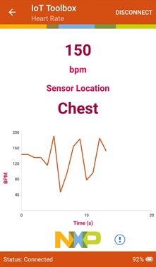

  6. To see all your process running, you can download the ‘IoT Toolbox’ from the app store to your smartphone and connect your device with the board to verify the random data that the heart rate sensor example generates.
