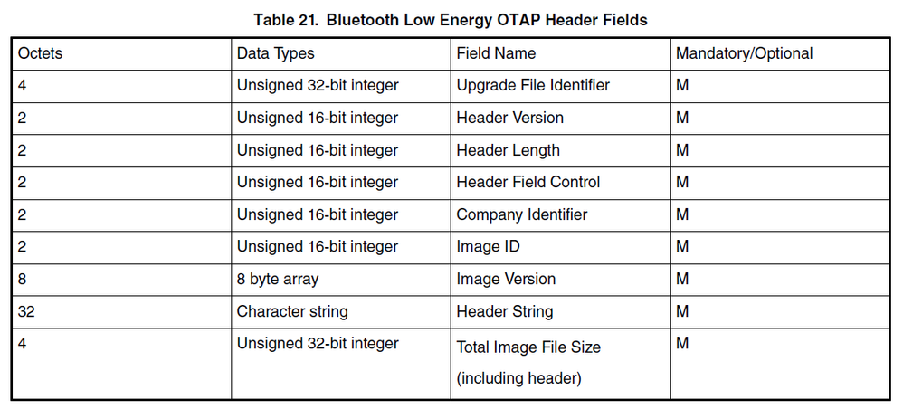

OTAP Header and Sub-elements
OTAP Protocol implements a format for the software update that is composed of a header and a defined number of sub-elements. The OTAP Header describes general information about the software update and it has a defined format shown in the following figure. For more information about the header fields, you can go to 11.4.1 Bluetooth Low Energy OTAP header chapter of the Bluetooth Low Energy Application Developer's Guide document included in the SDK at <SDK_2.2.X_FRDM-KW36_Download_Path>\docs\wireless\Bluetooth
