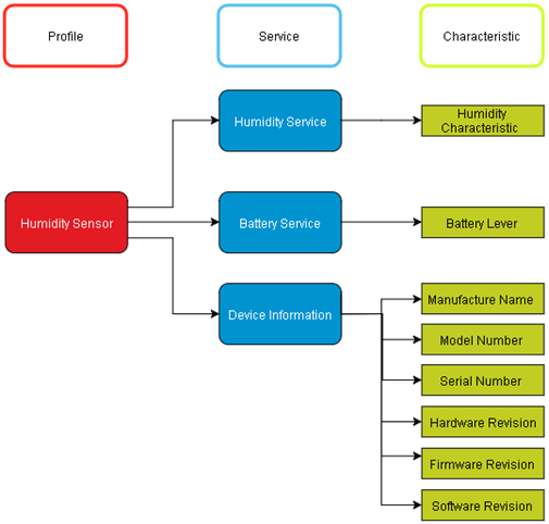

The Humidity Sensor is going to have the GATT Server, because is going to be the device that has all the information for the GATT Client.
The Application works like the Temperature Sensor, every time that you press the SW1 on USB is going to send the value.
On the Temperature Sensor demo have the Battery Service and Device Information, so you only have to change the Temperature Service to Humidity Service.
Figure 3. GATT database of Humidity Sensor
     First thing to do is define the Humidity Server that has 16 bytes.

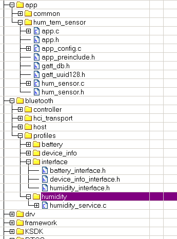

     Steps to include the files into the demo.
1. Create a clone of the Temperature_Sensor with the name of Humidity_Sensor
2. Unzip the Humidity_Sensor folder.
3. In the fallowing path <kw40zConnSoft_intall_dir>\ConnSw\bluetooth\profiles\interface save the humidity_interface file.
4. In the <kw40zConnSoft_intall_dir>\ConnSw\bluetooth\profiles save the humidity folder
5. In the next directory <kw40zConnSoft_intall_dir>\ConnSw\examples\bluetooth\humidity_sensor\common replaces with the common folder.

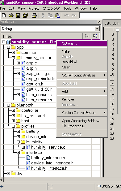

      Steps to include the paths into the demo using IAR Embedded Workbench
Once you already save the folders in the corresponding path you must to indicate in the demo where are they.
1. Drag the files into the corresponding folder. The principal menu is going to see like this.
Figure 4. Principal Menu
2. Then click Option

4. After that click on  "..." button to edit the include directories and then click to add a new path.
     Add the <kw40zConnSoft_intall_dir>\ConnSw\bluetooth\profile\humidity path.
Figure 7. Add a path
